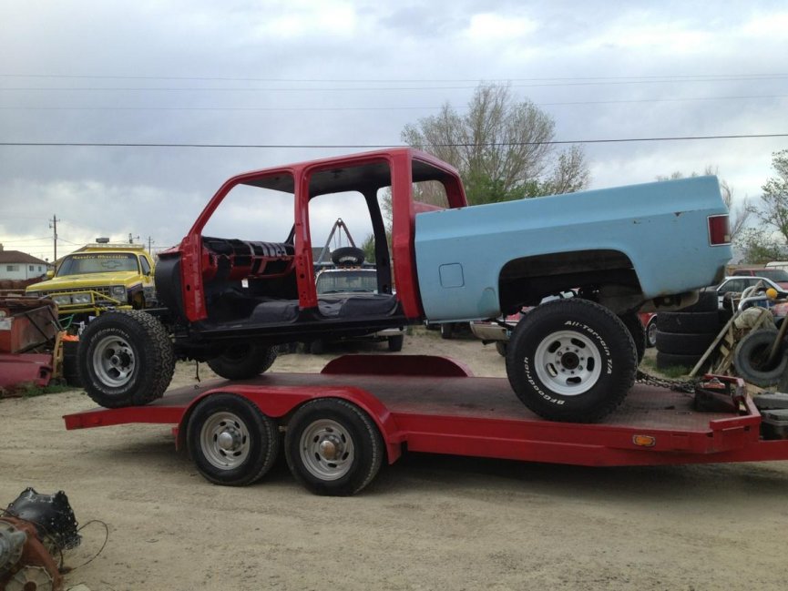

I got over 13 grand in my crew and its not even close to being done
but its a complete frame off custom build I got over 2 grand in my 4l80/205 combo
a stock 1 ton 4x4 square body has a 10,000 pound gvwr
2 wheel drive 1 tons are 9,000
