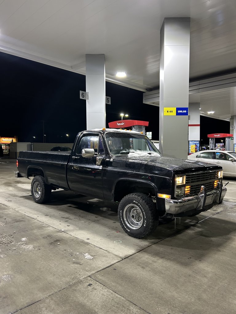

I recently purchased a 1982 k10 with a c20 cab. It is a running and driving truck. Recently I have developed a severe draw. With the headlights, heat, brake lights, reverse lights. They all draw. Going down the road doesn’t help. Will drop as far as the truck not running if not shut off. When headlights and heater are shut off the volts return. I have a 6 month old battery and have replaced the alternator. No change. Re run block to battery grounds and Ran a cab to battery ground. Any help is appreciated.
