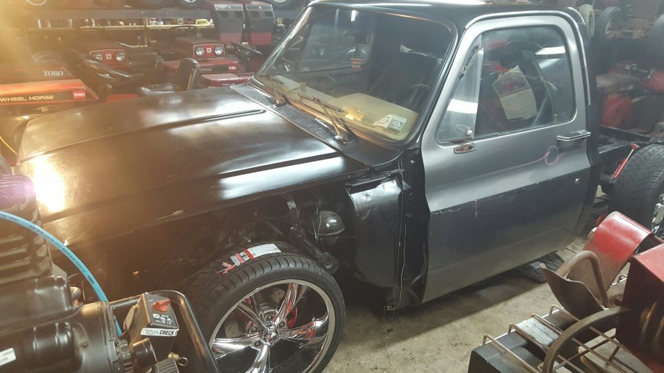

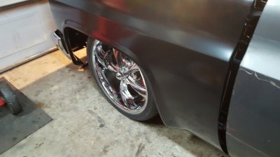

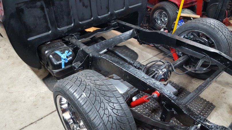

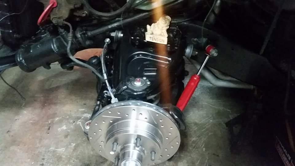

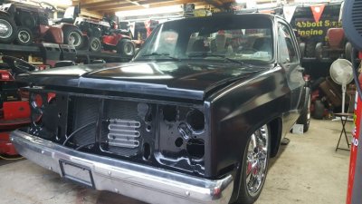

Ok guys im new at this so be kind with comments. I started off with this bubble gum 1985 chevy c10 pickup short bed which i always wanted to lower one. So i gather up all the information i could to started my build. Remeber up where im from snow country nobody does anything like this so information is hard to come by.:shrug: So my goal was to just drop the truck enough so the front wheels would just make it before they rub and the rear wheels the same. Trust me i would love to bag the truck it wont fit in the budget. So the front i replace everything except the lower control. Theres drop spindles in the front 2 1/2 drop with 1 inch slotted rotors. I also cut the springs down one coil link in which i think is my problem.(Shame on me to cut them i got bad info on that) Also added 4 new drop shocks. The rear flip kit and rear shackle to lower the back.
So the front is to low and many of my questions is when i add the bed back on in which i think its 500lbs with bumper how much more is it going to drop the rear end with the weight? Also should i replace the front leaf spring hanger i think its original and the guy before me was a hacker on this truck. Now for the front end if i put original coil spring back in the bucket i think that will bring the front end back up? dont get me wrong i love the truck that low but cant turn the wheels with out bag system. I dont care about the wheel wells i can lose them so the tire can move freely in there. also C notch the frame not a big fan but if its and option i will do it.
So overall im a mess on the truck and need your guys expert advice and please nice on the comments and my work im a rookie. This truck i been working on the last three months has kind of save me. I lost my job after 15 years about 4 months ago and ran into some health issues that wont allow me to get back for awhile. So my late nights working on it is helping me to keep busy into i can go back to work. Thanks Rookie

It looks like you've got about a 5/7 or 5/6 drop with your setup as is, so you lowered the front 2.5" with the spindles and cut 1 coil off a set of stock springs or 1 coil off some lowering springs?! One coil removed shouldn't be more than two inches of drop. Maybe even 1 1/2" per coil.

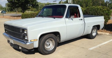

J knight is the man when it comes to this, well I'm sure there are others but he has informed me quite a bit in things and knows his stuff! Here's mine with 2 cut coils and a leaf removed, everything else is stock. The front springs have a rider in both springs to get the front up a bit, otherwise it's much lower in front.
Yea they where just stock springs I just cut off one full ring figuring the same thing in inches. I'm wondering if the coil springs are just worn out and are no good. Thanks I like the way yours sit.

My truck has a 5, 7 drop. The front...drop coils, drop spindles, custom fenderwells for tire clearance. I have 20x8 fronts and 255x45x20 tires. The rear...drop hangers, axle flip kit, overload spring removed and a mini notch for now ( bags are next step). The rears are 20x10...with 305x40x20.
You also want to check other clearance items such as the frame rails and your driveline since you have the bed off. I notched and reinforced my frame crossmembers in order to make sure there is not interference between them and the driveline while the suspension cyles.

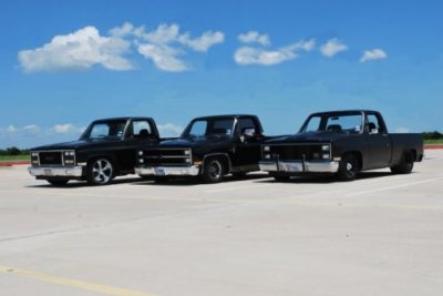

You shouldn't be that low with 1 round cut off the stock springs and spindles.
I have never had an issue with cutting springs, the spring rate debate is nonsense imo. I hear more complaints about the ride of drop springs than the ride of cut springs. Both my trucks have cut springs with no issues.

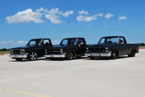

All three trucks in the pic below have spindles and cut springs(one round).
Are the springs you cut original to the truck? You said the PO was a hack, did he cut them before you got the truck?
I don't see anything wrong with your hangers, not sure why you would want to change them.
As far as the c-notch, you need a minimum of 2in of clearance between your axle tube and the bottom of the frame with the bump stop bracket removed. Less than 2 notch it, more than 2in you don't have to.
