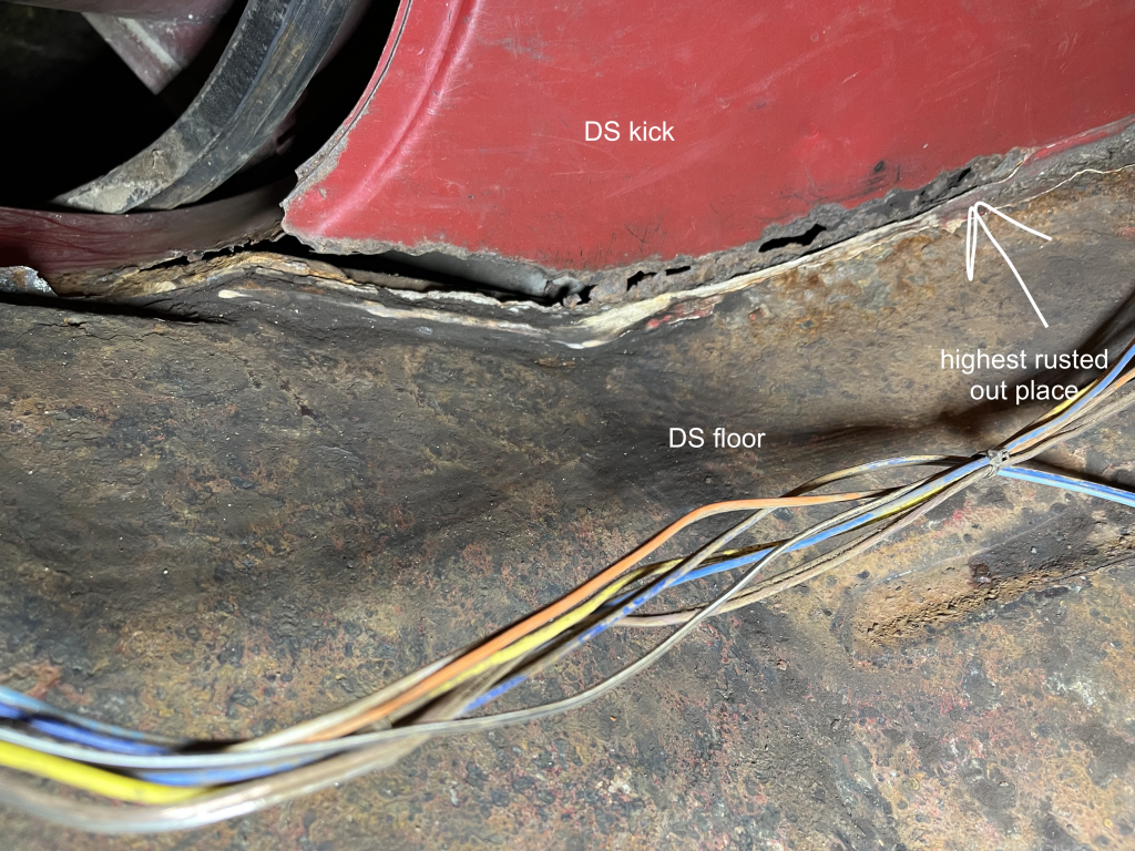

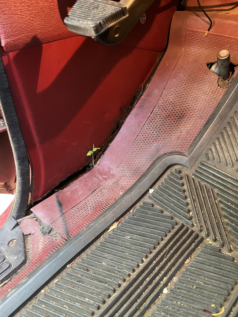

Need some advice from y'all who have done this before (which seems like an awful lot of you). '83, daily driver. Outer rockers had a few pinholes. Small holes under the plastic step trim were growing. Where the kick panel meets the floor, I knew it was rotting but didn't pull the vinyl and jute until an unwelcome visitor showed up this weekend, see photo.
Pulled the vinyl and the jute was soggy. The paint layer on the floor was scaled up and muddy. I knocked off some of it with a die grinder and the floor seems pretty solid. The fact that the flakes had nice paint on one side makes me hope there may be good (enough) metal still left to POR-15 and keep.

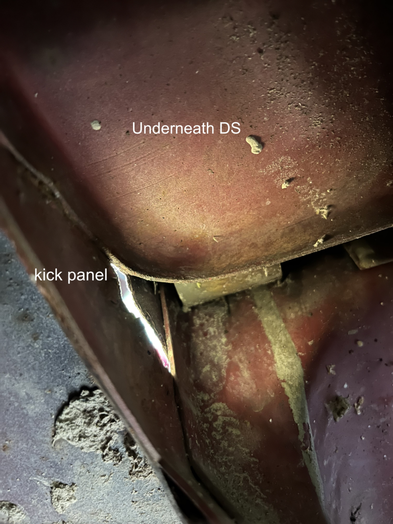

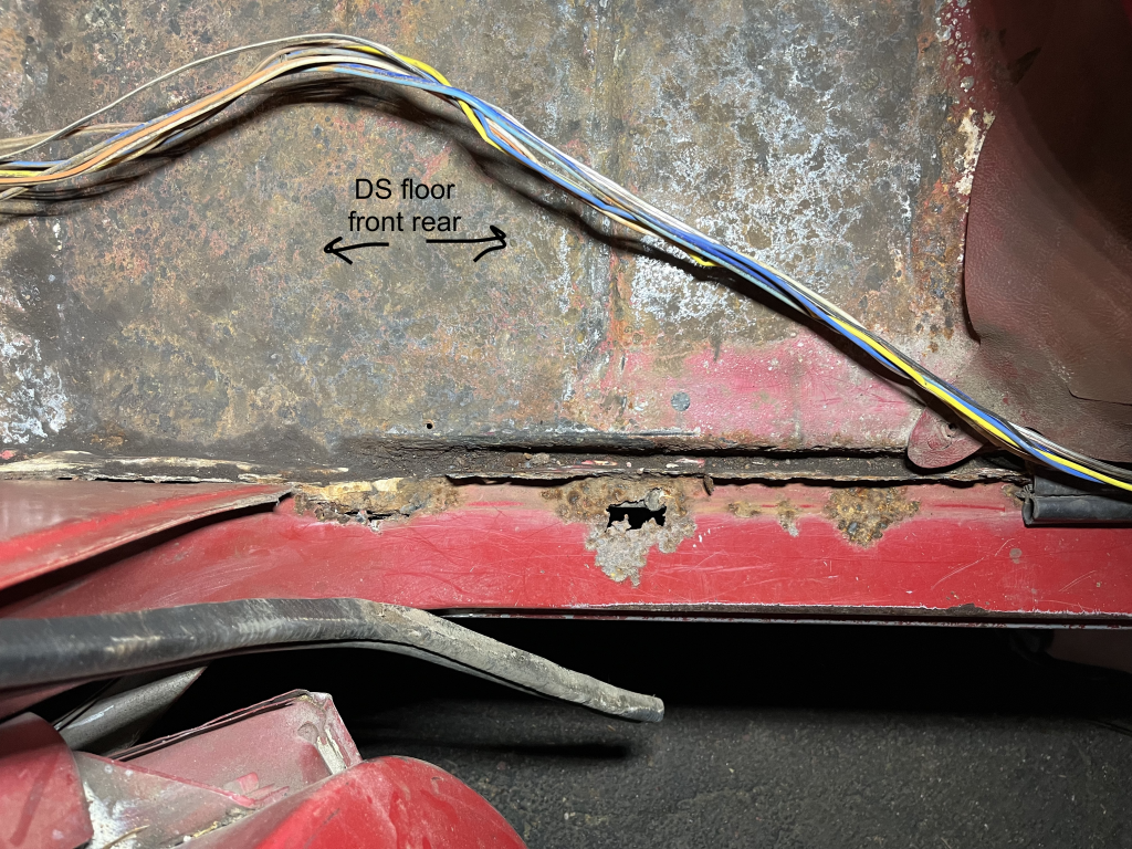

But the kick panel is rotten and the lip of the rocker is rotten. From the underside, the inner rocker looks fine. The passenger side looks like it's the same story - wet floor, hole in the kick where it meets the floor, inner rocker fine from below and outer rocker developing holes.
So, to the experts: I have to do the outer rocker. Should I do the inner rocker while I'm in there? Assuming it's sound - will I tear it up anyway as I'm drilling out the spot welds to remove the outer? I assume I need to replace the kick panel, but from what I've read in the threads it sits at a busy intersection and I have to remove a lot to get it in there. Fender's no big deal to take off, but maybe part of the cowl? And possibly tricky to get it all aligned when it's time to put it all back together. If there's a simpler way to get it solid and watertight, I'd love to know.
Then lastly, where the floor meets the kick - I don't know how far up those replacement inner rockers go - do they make it to where the kick panel meets it? Hate to buy/ship/cut/weld the whole floor just for that little part.
Any advice is welcome. I've learned a lot from you guys.

Oh man, is that all? Unless you're going for a showroom quality restore you'll be fine. Find out where the moisture is coming from and fix that before anything (most likely door or window seal, maybe even cowl drains), after that some rust converter and seam sealer will fix that up plenty. For reference, here is what I found when I finally got around to pulling the vinyl floor up in my '08 GMC 2500HD last weekend. No cutting tools were used, just a few stomps with the ole size 10.5 boot...
Your truck looks just dandy to me lol. As I said, rust converter or maybe even an encapsulator, then a good fat bead of seam sealer and slap that carpet right back down. Should buy you a few more years before you have to worry about it, especially down south. Just figure out where the water is getting in from in the first place and solve that before anything.

both welded then sealed
