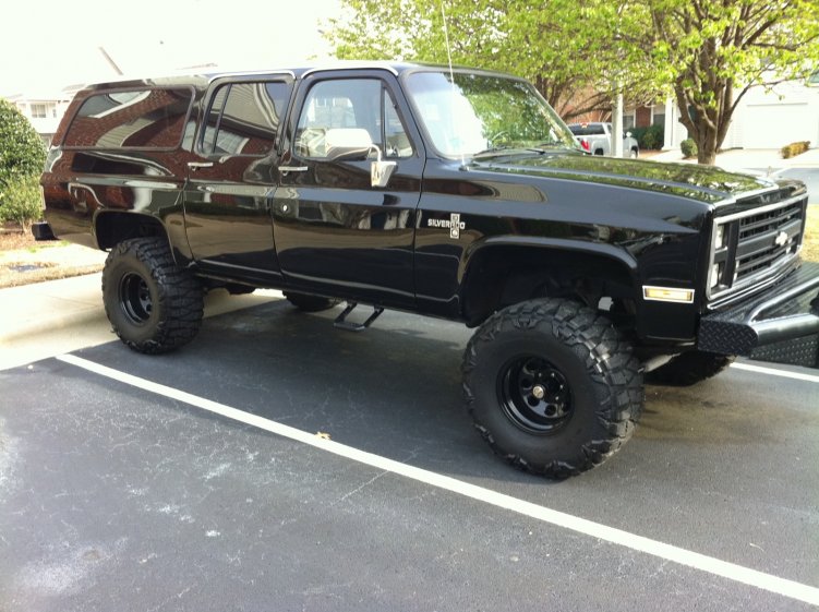

I am running 15 X 10 with 33s 14.50 but this in a 4inch lift. Has a beefy look to it. They come out pass fender just perfect.
