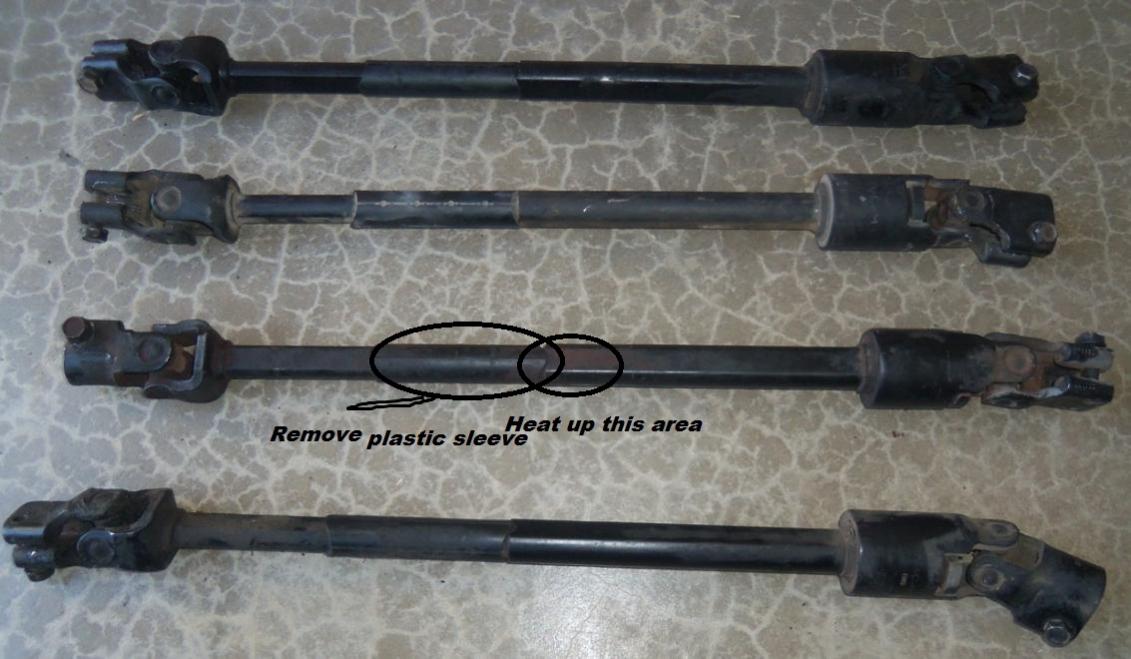

BTW, Retro, are these things supposed to be telescopic or collapsible? If they are, it's sure gonna be tough. They seem rock solid. Aren't they supposed to collapse in case of a front end collision so you don't get a steering column in your Adams apple?

No, they don't collapse easily, that's why you have to heat it up and melt the plastic rings that keep the two halves together or if you're like me and torch-less, cut the larger shaft's end and get the rings out and put them back together.

Not sure if it will be, I would imagine so. There's 2 small plastic rings on the smaller shaft that the larger shaft slides over from the factory, they need to be removed so the shaft will be able to fit in place of the squarebody steering shaft.
Maybe this will help explain. I didn't take any pics. Maybe I'll grab one next time and do a better pic show. Perhaps send it to Stoked since I don't think my '88 can use it.

Ahhh, OK. That makes sense. So I'm actually going to remove that sleeve. I guess the sleeve is actually just a stop to size up the shaft. :shrug: I see the white plastic in there. So first, get torch and burn that **** out. Bend and mangle the sleeve and get it off, then heat where the 2 shafts meet and small one slides into the big one to break them loose so they slide apart and together.

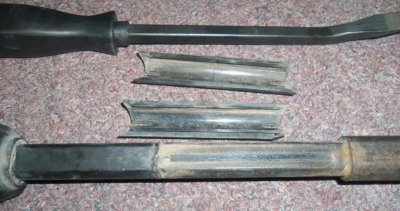

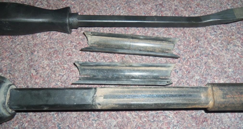

OK Retro Honey, just for you. I did some work on this. Actually the sleeve didn't need heated up, I just pryed it apart, it kinda snaps on. Being it's not going to be reused, doesn't matter if it breaks or not.
attachment.php
Now for the heating up or cutting the large shaft part. I'd suggest don't do the cutting at all. There's a reason I'll get to. As far as heating it, OMG, took forever and ever using a propane torch. Mapp gas gets hotter, maybe that would be better, but the propane does work. DO NOT BREATHE these fumes. I did this in the garage with it closed up. I am feeling very sick now. Sore throat, eyes burning, sniffles, upset stomach etc. So do it in a ventilated area. I didn't see a good place to hit it with a BFH to help it along that wouldn't possibly hurt a joint, or knuckle, or bend the shaft. So squared up the connecter on the ground and pushed down as I heated, and why the fumes were coming straight up in my face. Finally after about 15 minutes of heating it up, and watching this nasty stuff leak out of the shaft, it let loose and the whole shaft finally collapsed and the bigger shaft ate up the little shaft.
