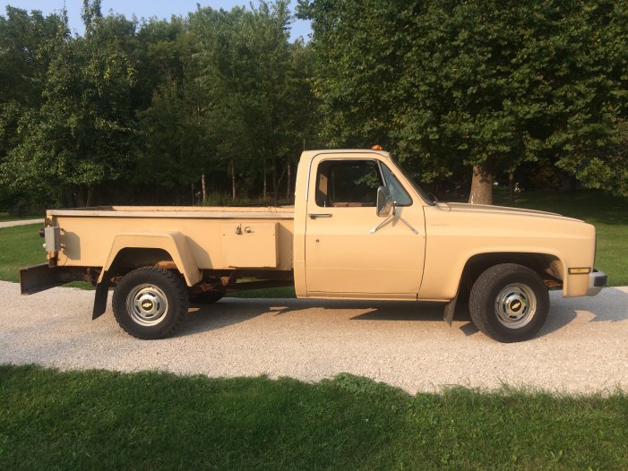

I figure it's time for an update. The decision was made to sell the little econobox I have be using as my DD rather that get rid of my most beloved square Butterscotch. This truck has some serious front suspension rust on the control arms and is nearing the end of it's days as a driver. The silver lining on Cilfford is that my Dad has been enjoying messing with it and has pulled the core support forward so the fan clears and it runs, pulled what was left of the bumper off and has pulled the sway bar off the truck and out of the front springs. It was jammed into the left front spring so far it was lifting that corner of the truck 3" giving the illusion that the frame was seiously damaged because the tire camber seemed way off " tipped in on top" now that that is pulled out the truck sitts just like it did before and has full range of travel for the steering. Anyway, I was never fully all in committed to Clifford because Butterscotch has always been my favorite and has now survived 3 vehicle purges where I was kept rather than sold in a time of need. The box and rear bumper are also home made pieces and are bulletproof. So.... The plan is to cool it until the insurance is straightened out and then continue to asses the damage to Cliffords frame. If it checks out and is usable we plan to strip down to the frame and start working our way up from there ultimatly ending with a rebuilt butterscotch truck. A sort of new and improved version.
