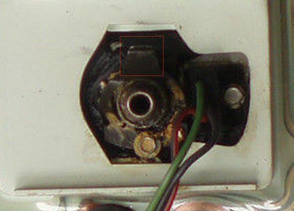

There is a clip that you push in that releases the cable. Reach up under the dash and push the clip towards the cluster to release.
This pic sucks but you will get the idea. You will need more curse words.
