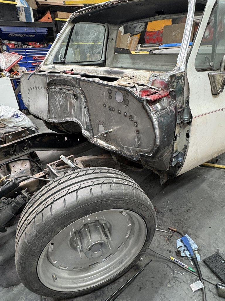

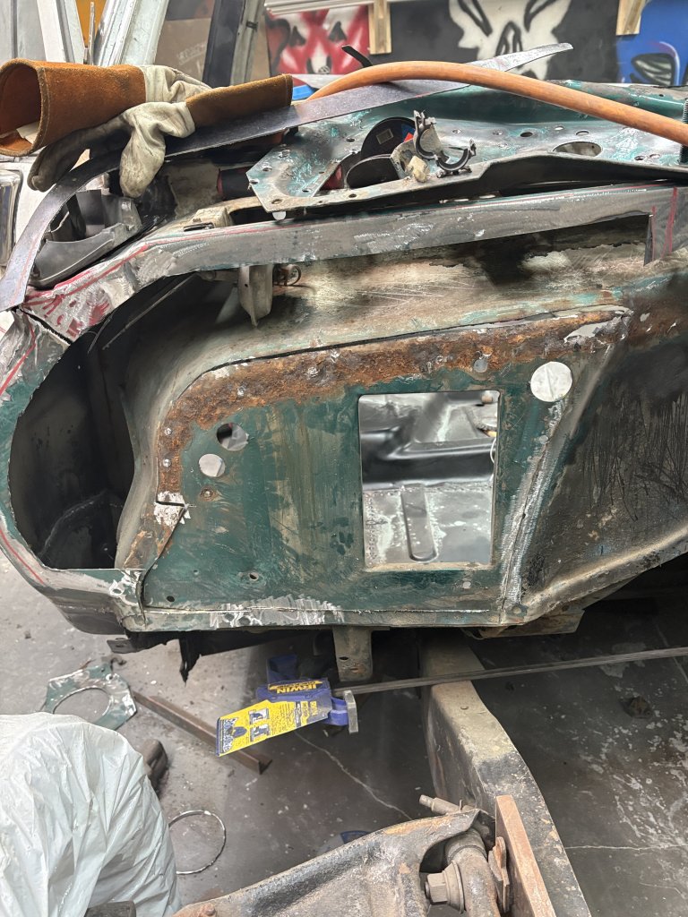

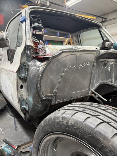

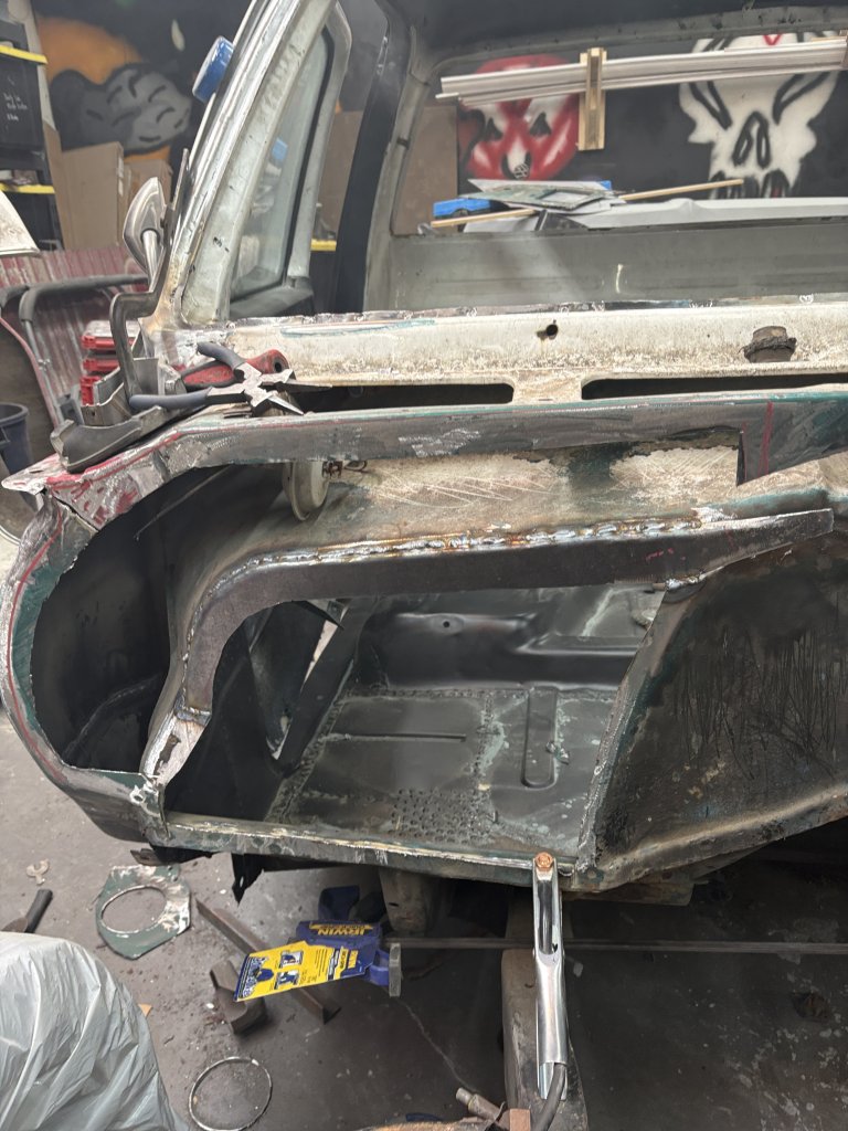

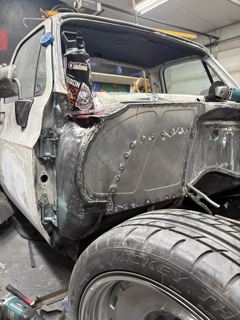

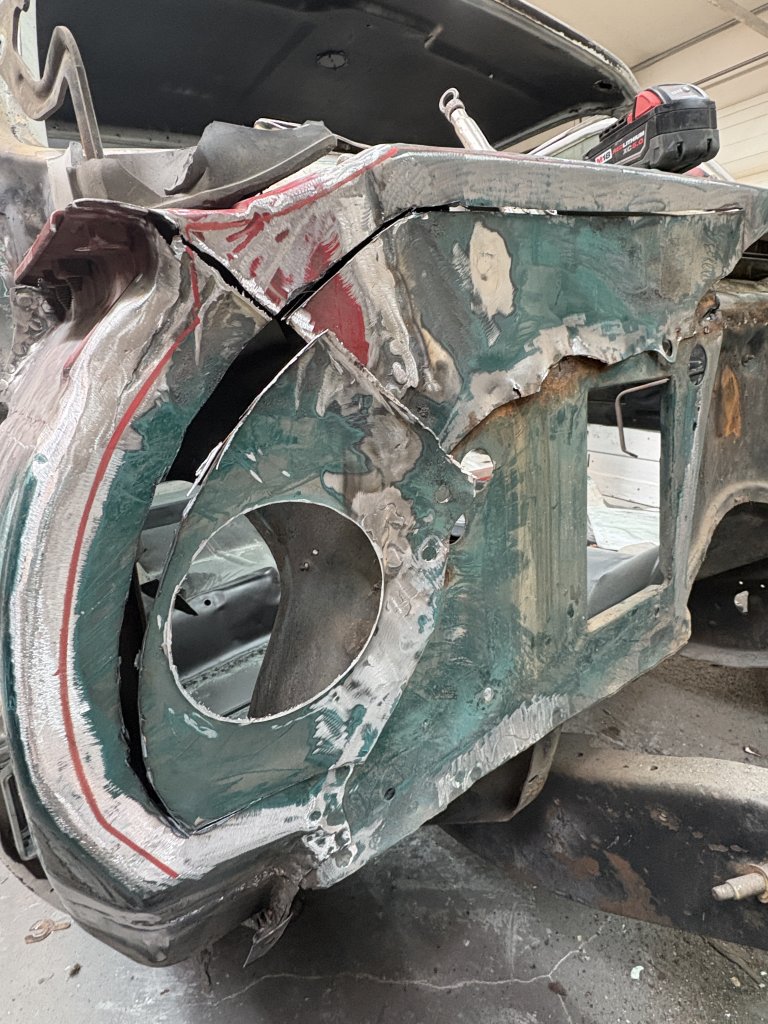

You’ll need a housing without AC, hole remains the same but until you get the heater core housing assembly without AC - it’s a can of worms. I’ve been in progress of replacing firewall as my rain tray got so corroded it began to leak on the interior- AC was non repairable due to Environmental BS, so Vintage air here we come

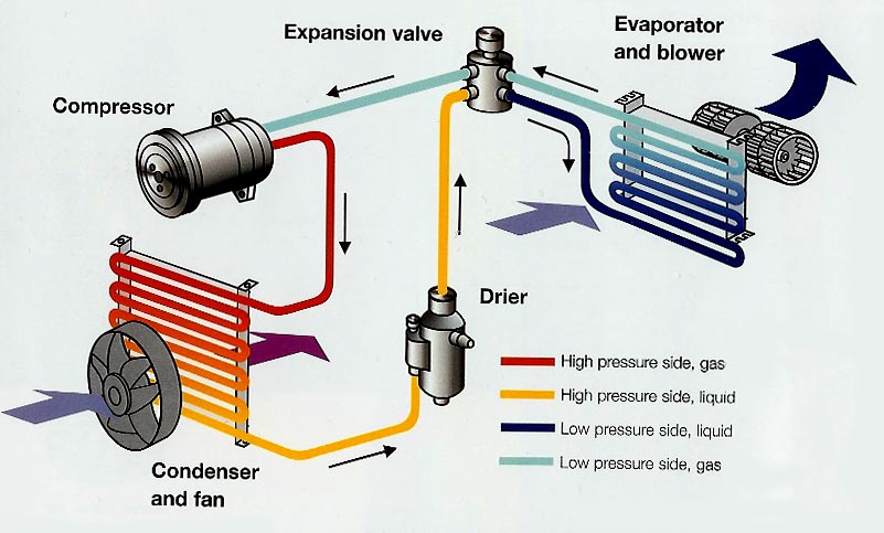

Ya, A/C is really complicated if you have never worked on it before, but its actually really simple. Lot of people will help you with info and advice. I would keep the A/C in place for sure. We can help you get it recharged and everything.
