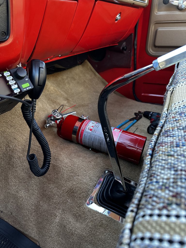

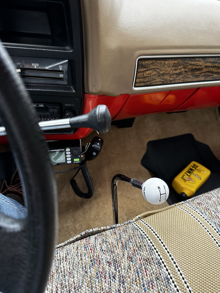

Thanks that was indeed a problem for me. I bought the Hurst 366809
van and pickup shifter. It was tall enough to technically use, but not comfortably. I used a coupling nut to extend the knob back toward the driver and a little higher. Now it feels pretty nice. Wish it was a little less chunky looking, but it’s not too bad.
Any advice on whether I should try to remove the column shift lever?
