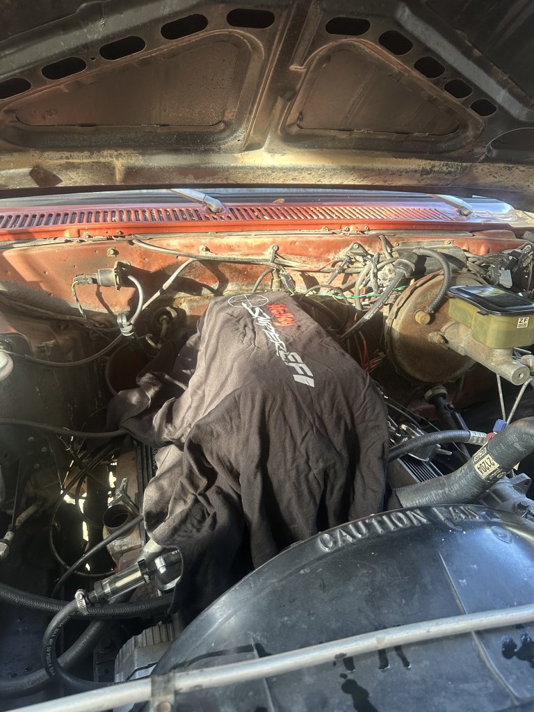

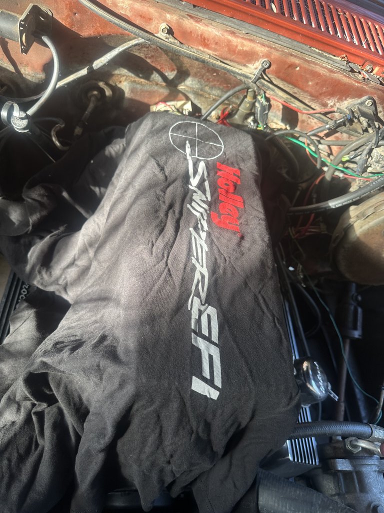

Well I did it. I couldn’t decide which way to go so I put both on my truck.

They sent me a Sniper Shirt as they were out of the other Holley shirts in XL.

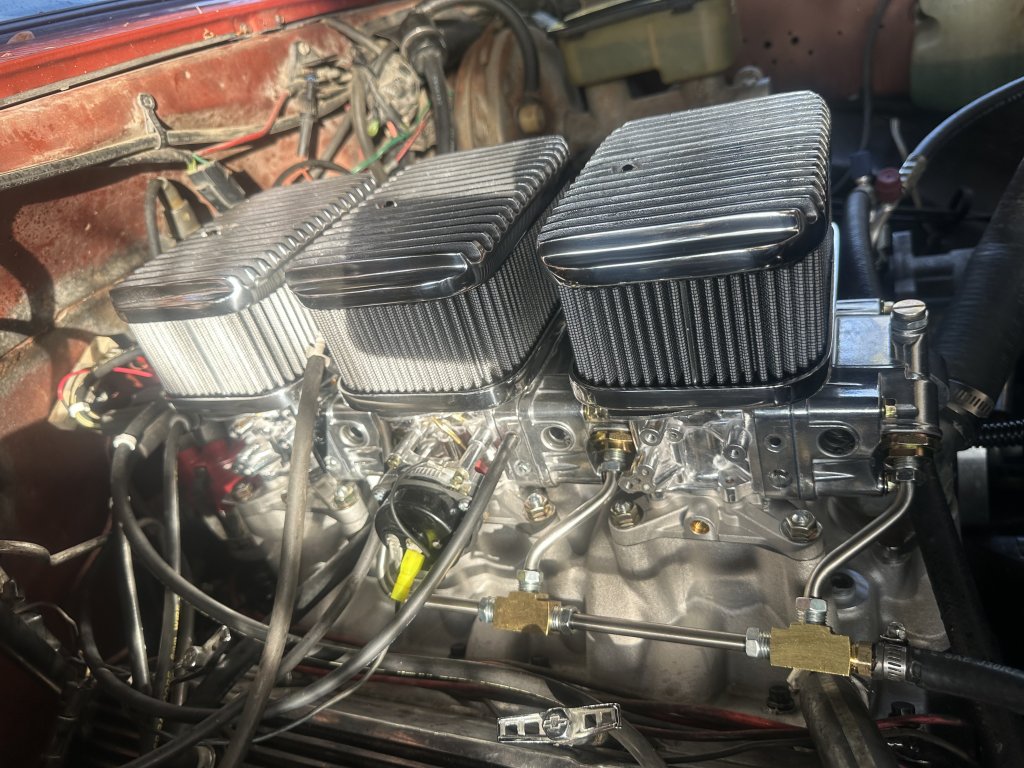

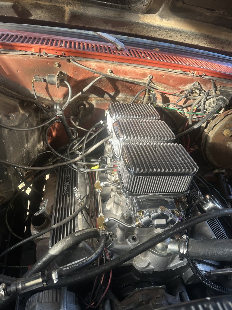

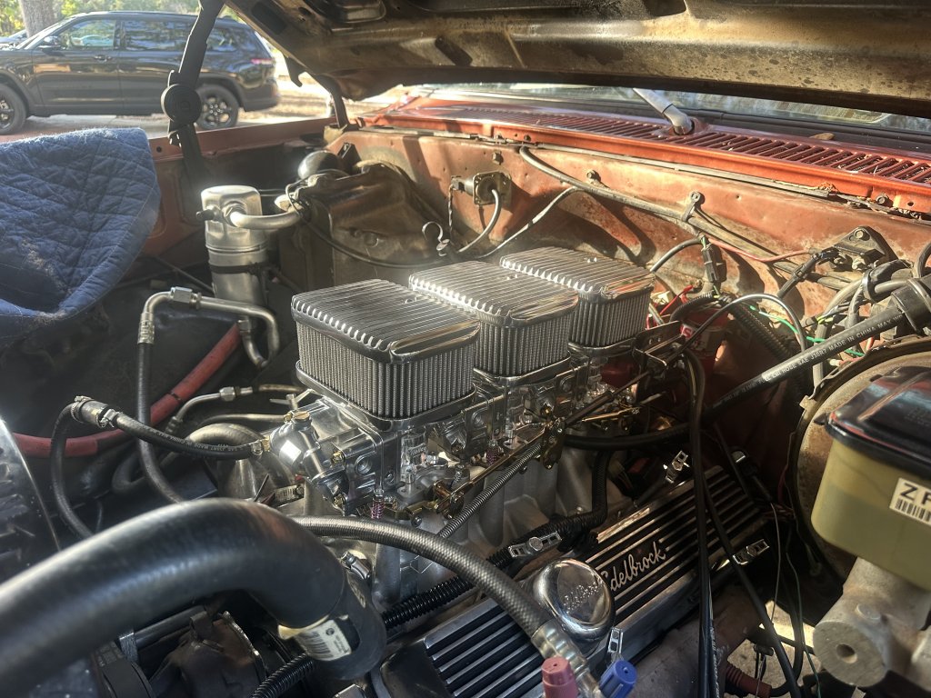

But here is what the new set up looks like.
I had an Edelbrock RPM Air Gap with a 770 CFM Holley, but it was sucking down the gas and I’d only get around 8 mpg. And it would stall on a hard acceleration from a stop, even after changing the jets 4 sizes smaller. The carb was too big but GM put on Quadrajet carbs that were 850 CFM and I tried two different Edelbrocks, one a 600 CFM and the other a 800 CFM) that I had but I don’t like those.
The carbs from the 427 could have worked somewhat but not satisfactory due to them having a divorced choke.
I am satisfied with the setup, but a person must know how to modify and fabricate stuff. It took about 8-10 hours to due to having to fab parts and modify the accelerator linkage.
