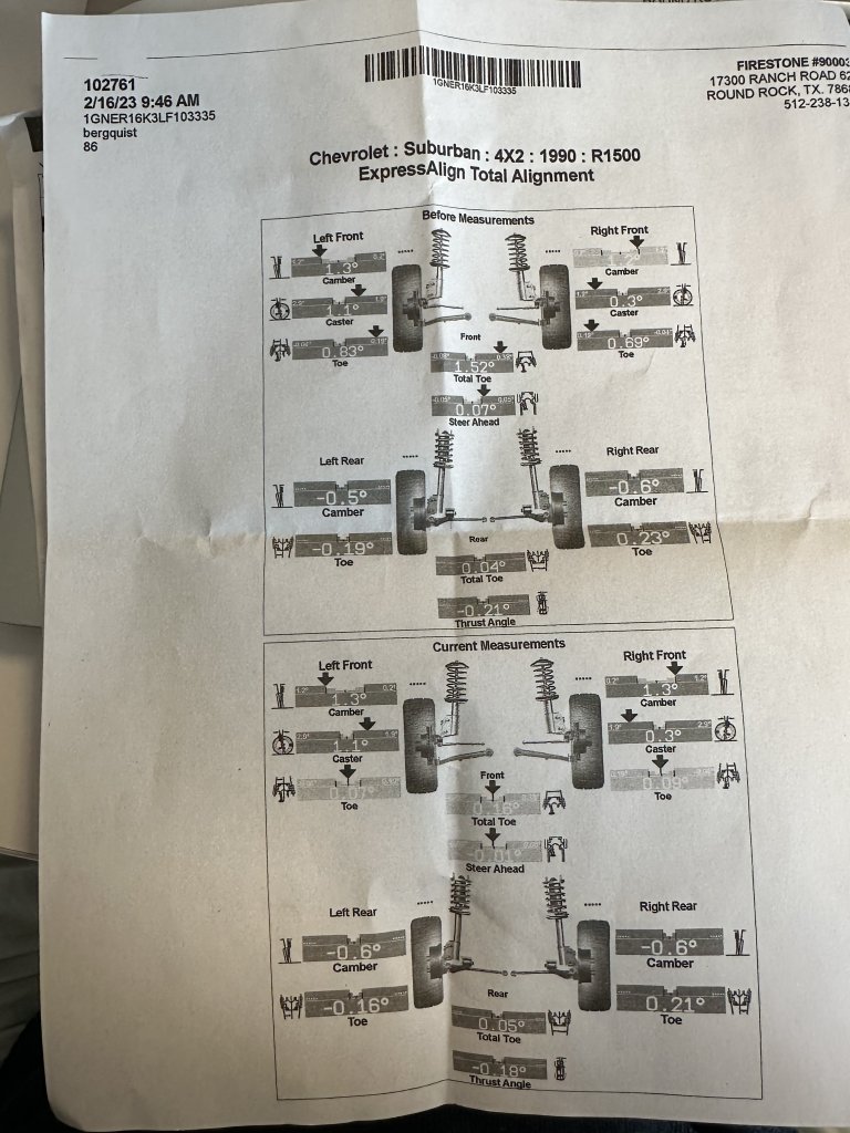

.2 degrees is going to be about 1/6th . Take the weight off right rear with a hack. Put your hands at 3 and 9 on the tire push in at 3 pull out at nine and vice versa,do you feel any movement?

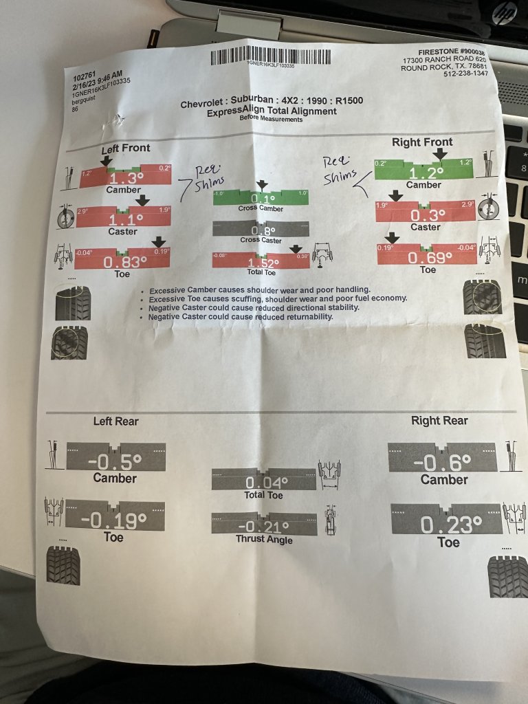

The one in black and white is the most recent one.

How did the OP notice the left rear wheel has two tenths of one degree toe out? Pretty sure it's not noticable to the eye or a measuring tape. This whole thread is based on assumptions.
I looked at their printouts

I’ll try this. Right now the cars is going fairly straight but with alignments totally out of spec to compensate for the pull. Right front is turned in one full turn and front left 0.5 turn out to the left.
I assumed it was based on the printouts he’d been getting from Firestone. Icbw

He's since posted those. Now we have something to work with.
What’s turned in and out? The tie rod ends?

Haha yeah I figured Firestone weren’t the best. I very rarely use any shops for anything. Yes the tie rod ends are the ones that I’ve adjusted to make him not pull as much. But of course now the angles are messed up and causing vibrations and a snake drive.

None of this should cause vibrations.
However snake drive, aka wandering, could have several potential or multiple causes.
Play in steering box and or steering shaft rag joint.
Play in tie rods/ all steering arms (which you may have verified aren’t sloppy?)
Not enough caster. Idk what the spec is for your truck, but looks like you have almost zero positive caster. Feels like it should be more. But I don’t know the spec.
On another note, your rear axle just looks somehow slightly shifted fwd or back on one side. As mentioned, won’t cause pull, it’ll just dog track a little bit. Steering will/should center up to what the rear axle is doing.

I see the rear axle angles as a normal artifact of use. Probably due to bushing wear, metal deformation from life use. IOW, looks reasonable to me and not causing the main problem.
The caster values are what I see deficient. Both should be a positive value, but the drivers (left) front should have a half degree more positive, to account for road crown. A couple degrees positive caster is plenty.
Keeping front camber even and slightly off of zero is ok as long as they both lean positive or negative.
Thanks for posting the alignment sheets. It's really the only way to assess your situation.

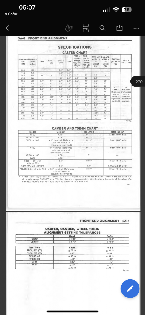

I took out the wheel bearing, it looked fine. I repacked it. Perhaps it’s the steering box that’s somehow screwed up.

Yes I have checked that there is no play in the tie rod ends. There’s play in the steering box though but not terrible for 200 000 miles.
