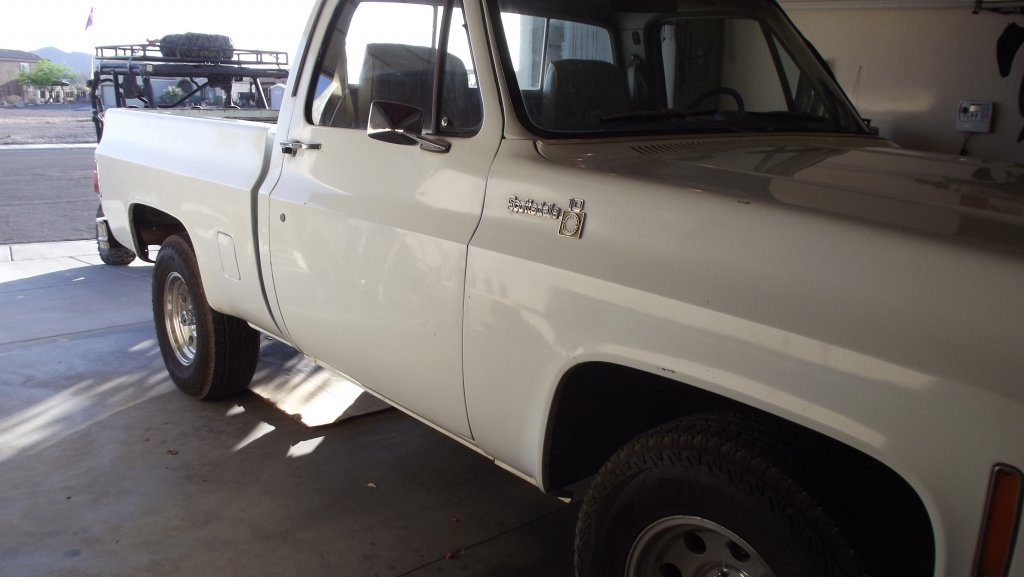

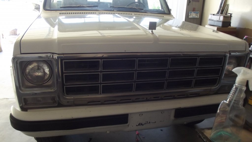

i AM CHANGING MY TRANSMISSION TO A 4L60E i ALREADY HAVE THE LS SWAP INSTALLED AND DRIVING BUT YOU JUST CANT SHIFT THE TRUCK 4 SPEED SM465 FAST ENOUGH.
SO I AM MAKING THE CHANGE TO THE AUTOMATIC.
i PRESENTLY HAVE A ONE WHEEL WONDER REAR END AND AM WANTING TO JUST CHANGE IT OUT WITH A DISK BRAKE POSI MAYBE OUT OF A TAHOE OR WHAT EVER .
dO ANY OF YOU HAVE THIS EXPIERENCE.
ARE THERE ANY THAT JUST BOLT IN PLACE THAT HAVE BOTH POSI AND DISC BRAKES.
FOR THE COMPLETE PACKAGE I THINK THIS IS WHAT I WILL NEED.
4L60E TRANSMISSION
AUTOMAT STYLE RADIATOR
DRIVE SHAFT LENGTH CHANGE
CROSSMEMBER
AUTOMATIC FLOOR SHIFT
POSI REAR END. (DISC BRAKES WOULD BE A PLUS BUT NOT MANDATORY)
IT IS A DOCUMENTED SPORT TRUCK WITH THE Z77 PACKAGE BUT IT WILL NEVER BE ORIGINAL AGAIN.
ONLY REASON I WANTED A POSI IS THAT PRESENTLY I SHREAD THE REAR TIRE THAT SPINS ALL THE TIME,
THE LS HAS THE FI TECH 500 HP FUEL INJECTION.
WOULD APPRICIATE ANY HELP OR SUGGESTIONS.
