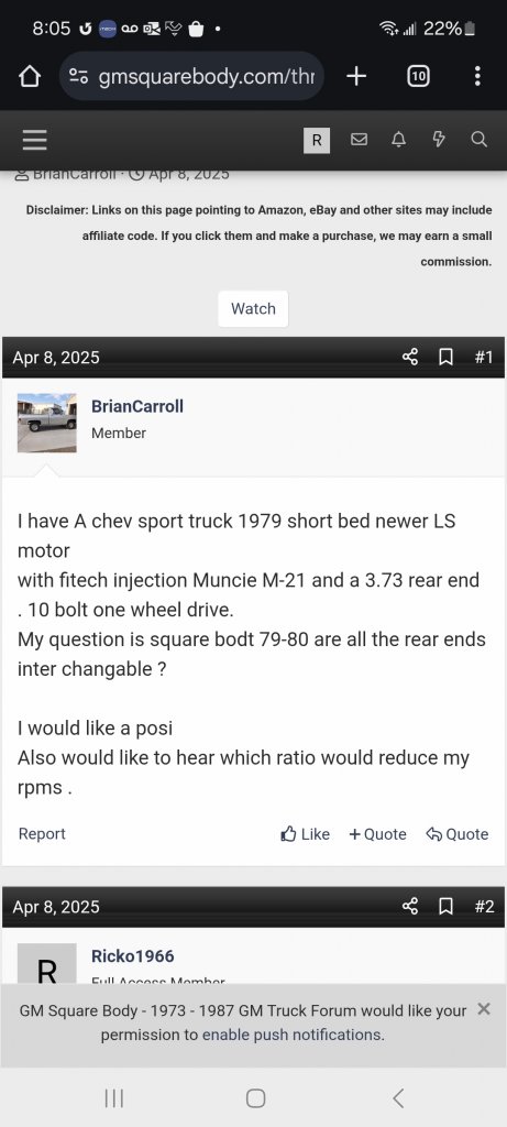

My 79 c-10 sport Big 10 has a 10 bolt rear end
3:08 I think one wheel drive. Can I modify this to a posi and what is the process.
I would just switch the entire rear end if I knew what other rear ends fit.
also my big ten rear end has bigger brakes than regular c-10s wider due to the bigger gvw.
And 8 leaf springs each side . I suspect my ring and pinion have excessive wear and I can pull the entire wheel out when on the hoist by anout 3/4 inch. i think that means the c clips are about worn out.
Any help would be appriciated.

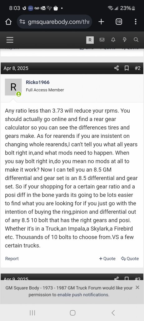

I've told you about this in the past.The last time it had a 3.73. You can get a rear diff out of any 8.5 GM Junkyard 10 bolt doesn't matter,car,van ,truck.8.5 is 8.5 swap the center diff,ring and pinion. Depending on certain years you may have to swap axles. But this is a simple bolt in.
