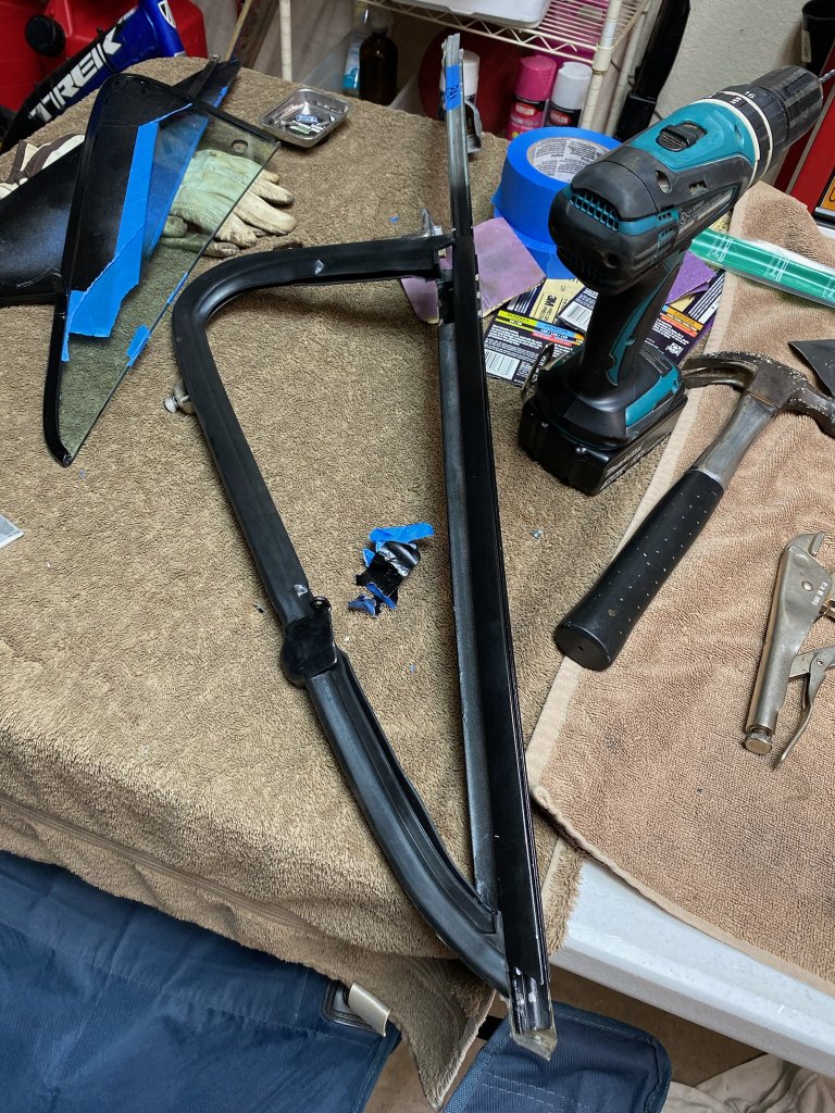

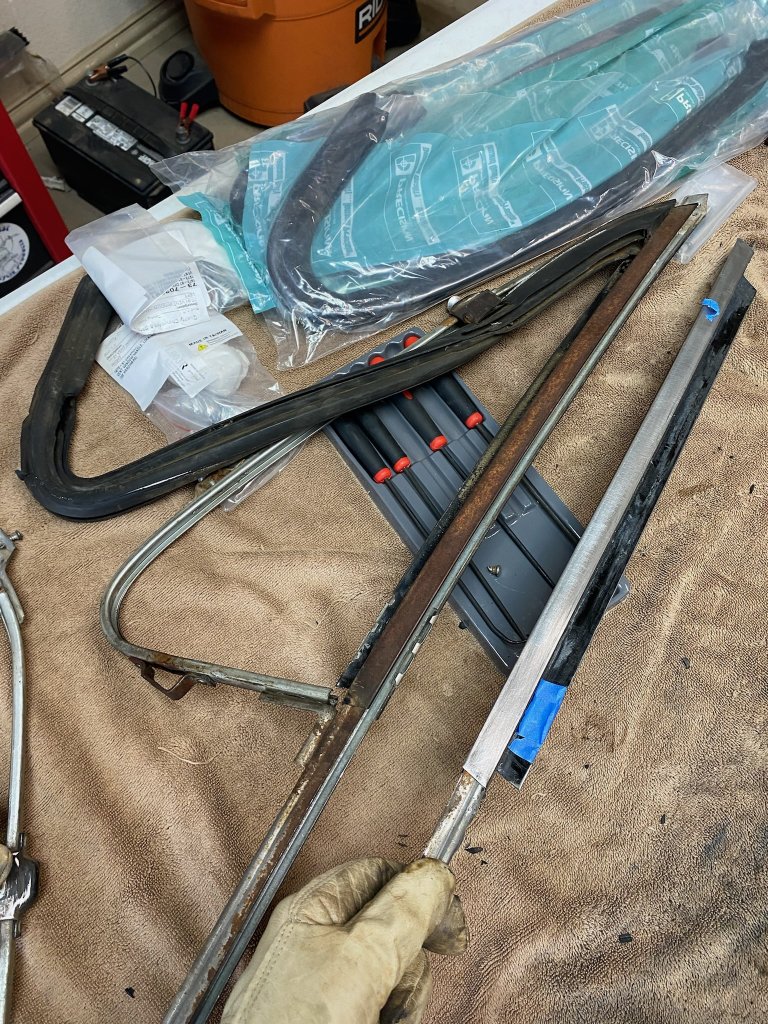

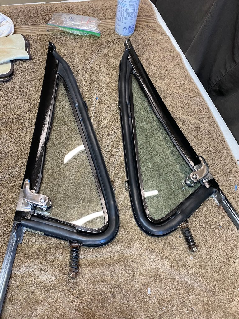

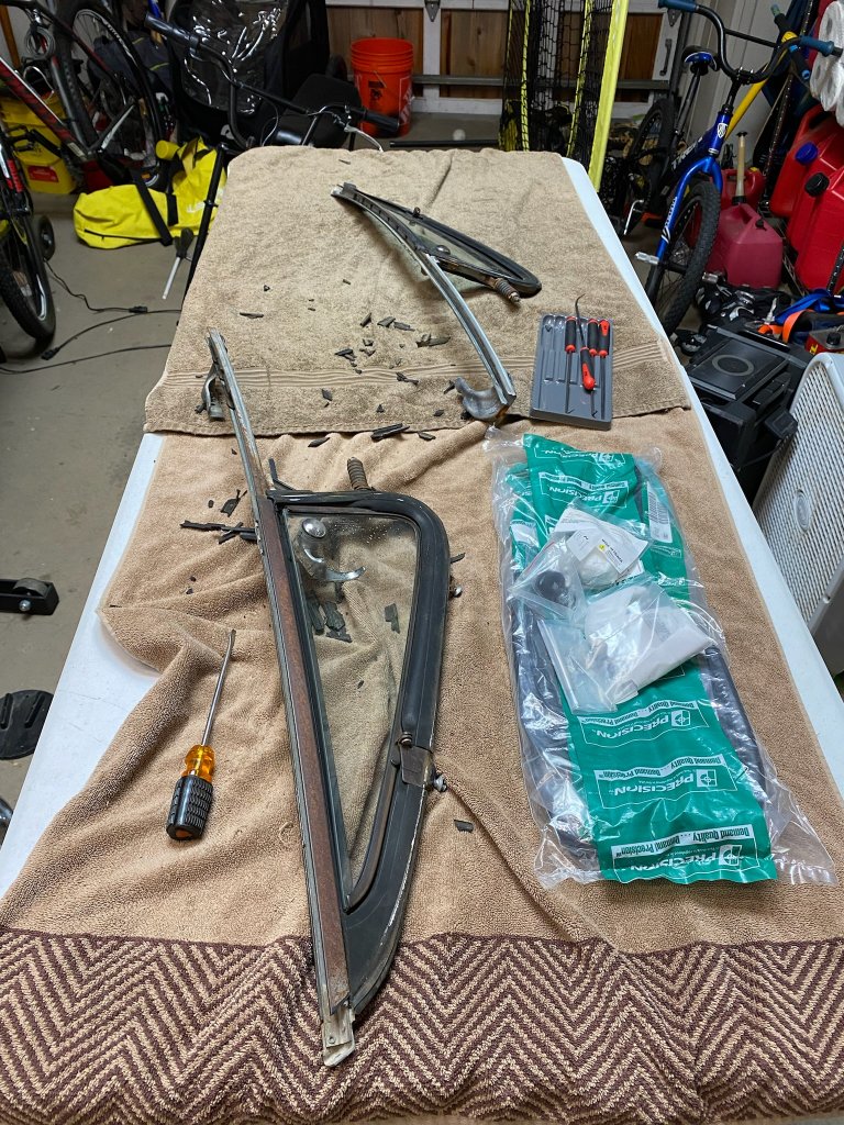

Back ordered is an understatement! That’s why we rebuilt ours. However the Precision rebuild program was very appealing.
Musta a note. You DO NOT have to take the frames apart to put the two piece seal in like you see on many videos. We took one apart and rebuilt it with the smash rivets and the drivers vent we left together. It took less time, but was a little harder to work the seal into place. Lots of glass cleaner and patience.. had to walk away a few times but definitely doable.

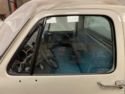

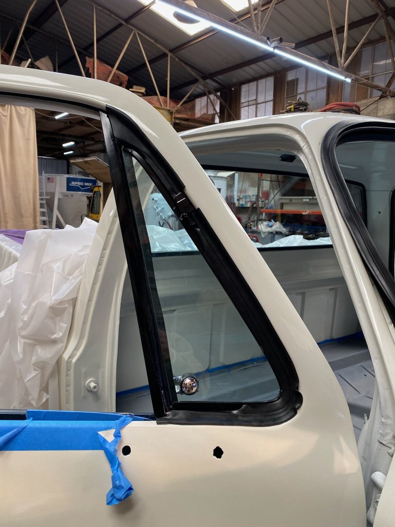

Does the interior rubber flap get tucked into the door frame or does it lay on top? I’ve seen people do both
Good question. I’m gonna say tucked in, by the one pic I have. (Need to stop n look at an original one. There’s plenty of em around here. ) But my inside seal lays down nice. Although it might not look “right” once I get the A pillar trim back in.

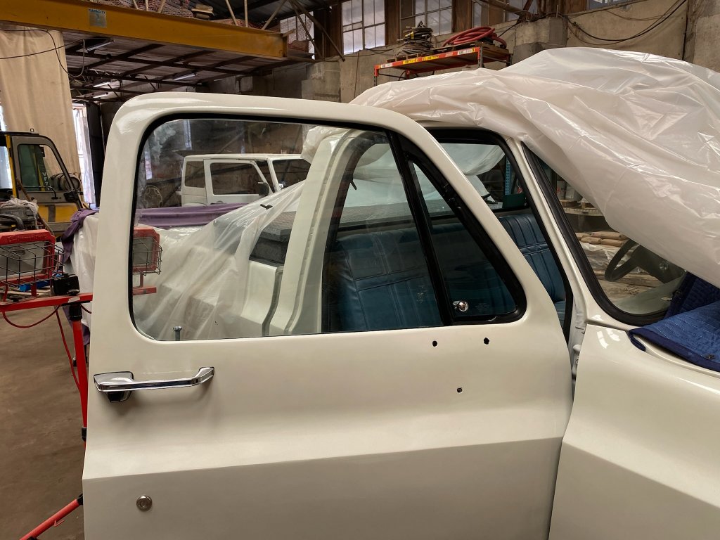

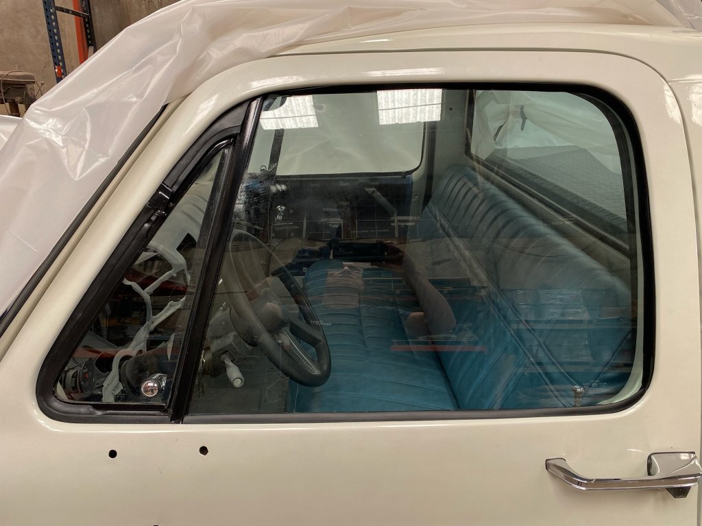

Joshua,
It gets tucked in. That was a fitment picture we took. Here is fully installed
