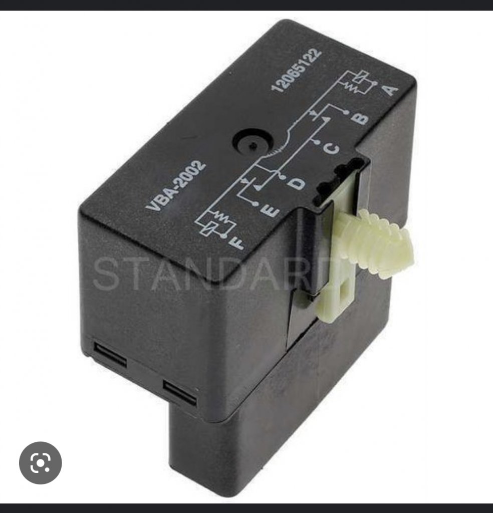

Another option: go to your nearest auto salvage yard. Find a door lock relay from a late 80hp early 2000s GM car or truck.
Looks like this: make sure you get the matching harness plug. The wire colors and function match up, the only thing required is to ground the black wire. The original relay grounds thru the mounting bracket, the late model is plastic and requires a ground wire.
I used this relay on my 81 GMC, I adapted G body door lock actuators on my 69 Olds, using this same relay. It works perfectly.
