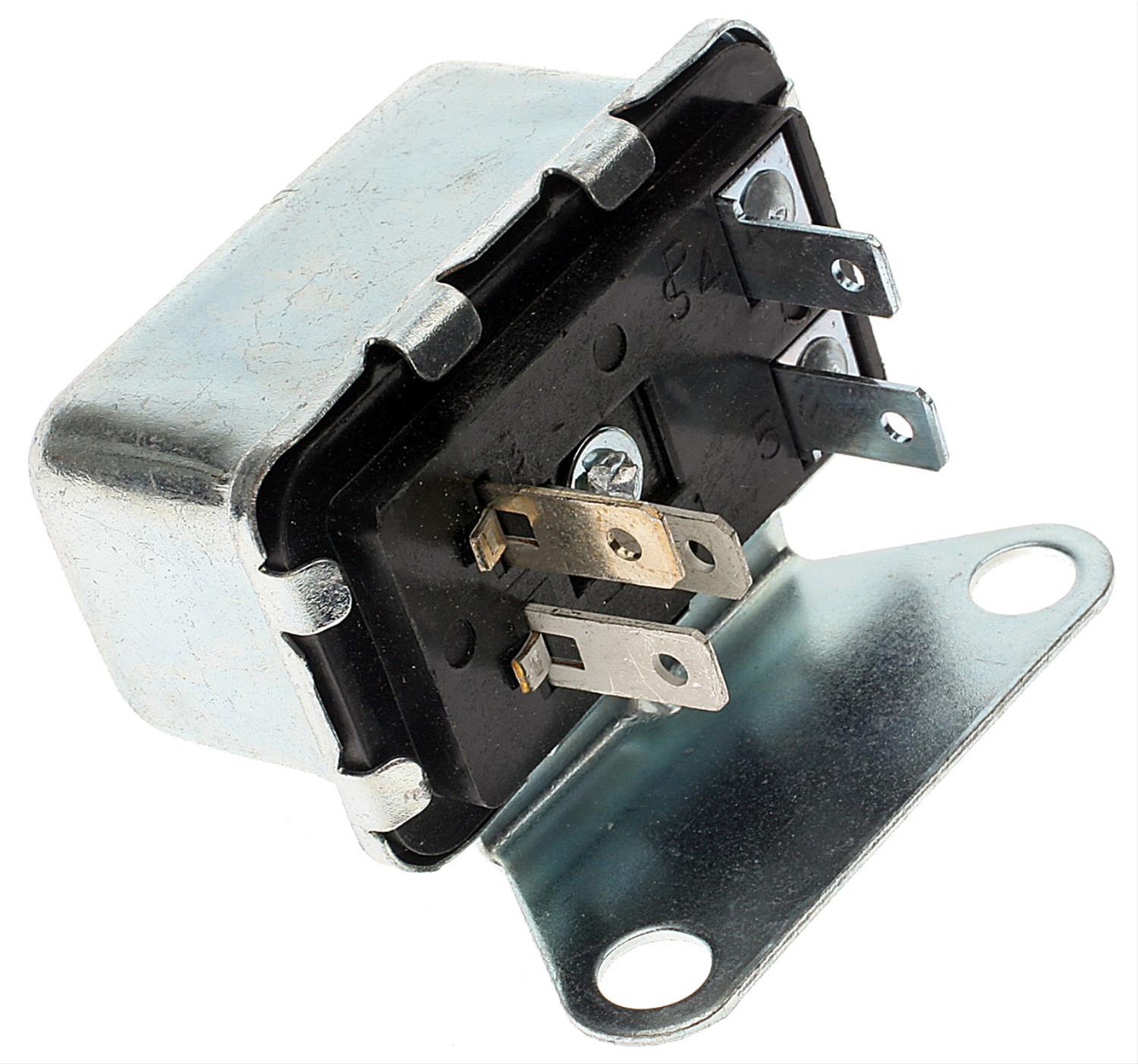

So I got myself a new AC Delco power door lock relay and the terminals are labeled 1-5, not the more familiar 80’s numbers.
My harness connectors do not fit on this relay. Fine, I will cut them and just use individual connections. Can anyone help me to decipher what the numbers mean?
I don’t think that’s a door lock relay. That’s probably why the connector doesn’t fit.

That was my initial thought. But I doubted myself since Summit says it is, or will work as one.
Then I got frustrated when the connectors wouldn’t fit and the numbers were different than the relays I’m used to seeing. So in frustration I went ahead and cut the wires. Used spade terminals and made the connections as Ricko1966 suggested.
Power locks work now.
