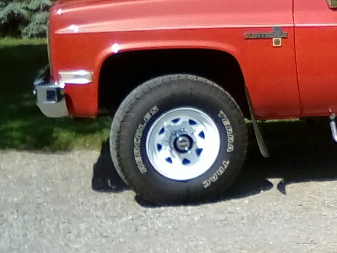

White spokes look good on old Chevys.
Indeed they do! Always liked them second best. What would be way cool is if someone made rally wheels in an 8x6.5 pattern... but as far as I can tell, those are unobtanium.
