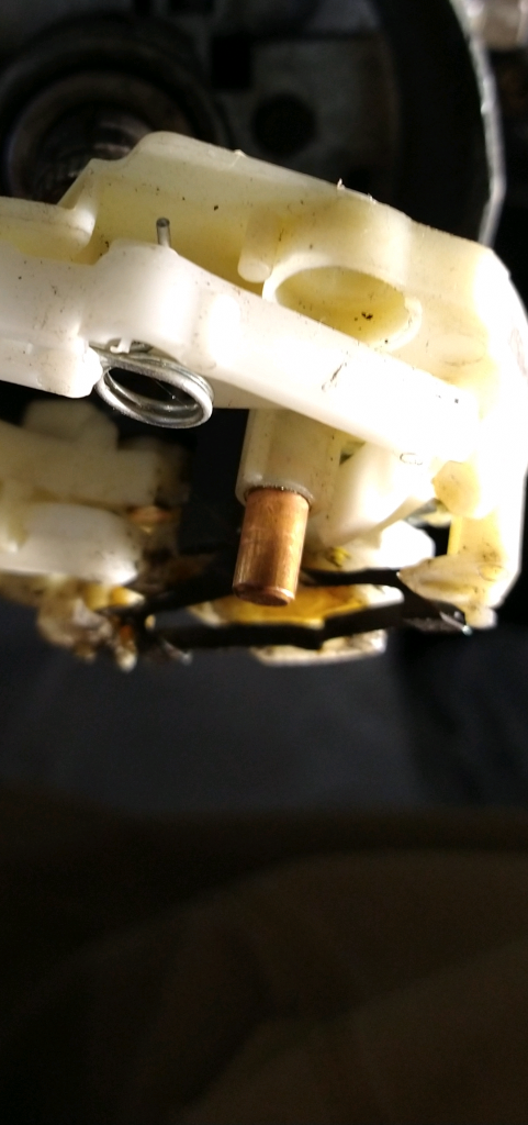

Run wires direct from the battery to the horn to make sure it works first. Doesn't hurt to take some sandpaper to the contacts and clean them up.
I had a recent issue where the horn contact in the steering column had a weak or pushed in contact spring. The horn contact cam would not touch it because it fell back far enough. If you push the horn button can you hear the relay making noise? If not, it may be in the turn switch. That peg in the photo is spring loaded. The spring could have lost tension from getting hot on a short or just worn. When it happens the cam won't touch the peg. You can also remove the horn button and take a screwdriver to the contact and then the center shaft at the same time and you should hear the relay it's as if you were pushing the horn button.
