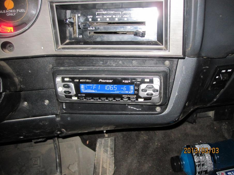

Thats what I put in my truck, I used the top right spot in the fuse box for the constant power. Works just fine for me. Red wire for ignition switch and yellow wire for constant power. Was the first time I put in a deck in any vehicle ane I got it to work right so anybody should be able to do it!!!!
