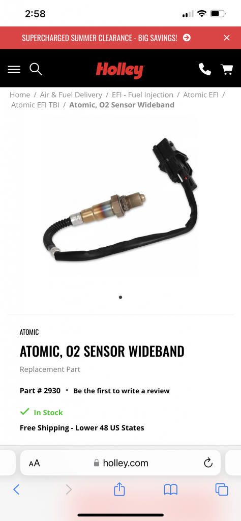

Are your colors grey white black yellow red? If so There's a pretty good chance the black wire is your narrow band signal. I wouldn't chance tying the two computers to one o2 sensor. I'd run both O2 sensors. The reason I said there's a pretty good chance,instead saying lm sure,I couldn't find info on your part number O2 sensor, I'm sure it's rebranded made by someone else . The diaghram I found was a generic wide band diaghram ,that uses those colors. Good luck

Ground your voltmeter probe the black wire with the engine running,your looking for a voltage between .1 and 1 volt .5 is just about stoich. Test this signal by creating a vacuum leak by pulling a hose, your meter should drop voltage until the computer compensates. Spray some carb cleaner in the air cleaner your voltage should climb briefly. So if you get the varying signal more than .1 less than 1.1 you found the signal wire. Now if this fries the atomic ecu( not saying it will,but) who's going to pay for that? Take it to an exhaust shop and have someone weld in a bung for your O.E. O2 sensor. Or don't, it's your car.
