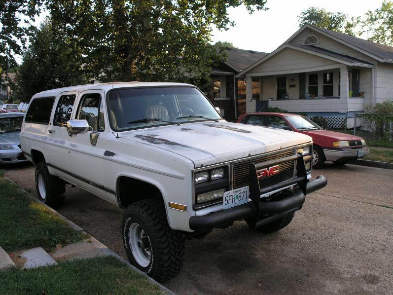

I have been looking at Pro Comps 130watt 8" and 6"_last Burban had 4 Hella lights cant afford 500 bucks worth of lights this go round.I will leave a pic at the bottom.Room isn't an issue and neither is amps,alt went feet up so i just kept digging thru part numbers till i found a 132 amp..
Want real experience with what your running or have run.Me always been a Hella or KC guy but these 130 Watt 8" and 6" aren't nutty on the price and if they work properly hell should be able light up small ball field.
