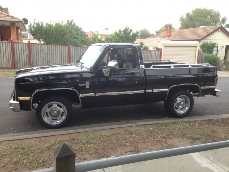

Here is a picture of the money pit as it sits now .

Things looking nice man!

Yep definitely an LS candidate!

X2i was thinking the same... just didn't want to say it

Ah, that's a nice one! And I've been seeing those factory bed rails all over the place recently.
