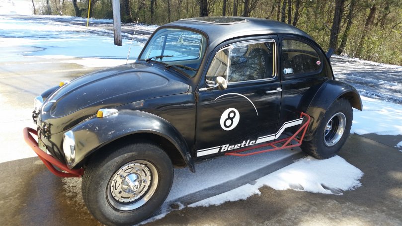

As much as I hate it being down I'm not in a real big hurry to fix it for one reason...
This is what I'm driving till I get the burb Goin again..

Cool toy!

Wish it was mine... borrowing it from my dad for a while.. and no he won't sell it to me, been trying for years.
