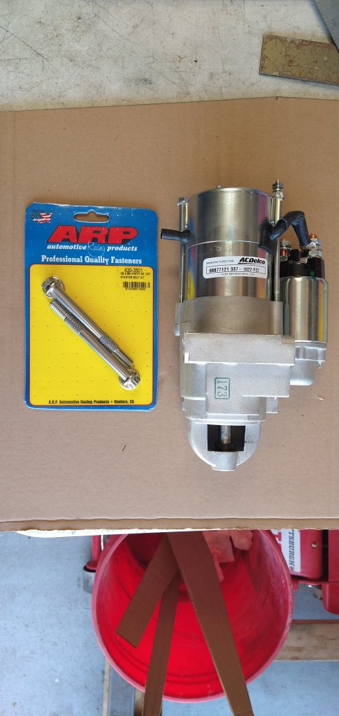

Well, RockAuto delivered today. Amazed how light this is! I was like, there's no way there's a starter in that box. Wrong. Lol
