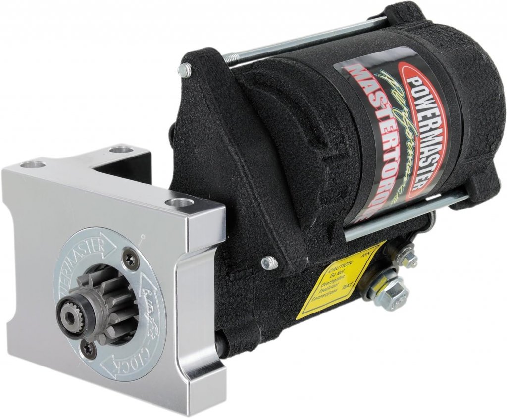

I have the Powermaster #9612 on multiple Chevy 400 small blocks and they have been very reliable. One source of a "bad sounding starter" is poor gear mesh between the starter and flywheel. Proper bolts are part of the equation, but you also need to check the spacing to make sure the gear mesh is correct. It is not uncommon to have to use a thin spacer. I believe the Powermaster comes with them, just in case you need them. If not, they can provide a set.

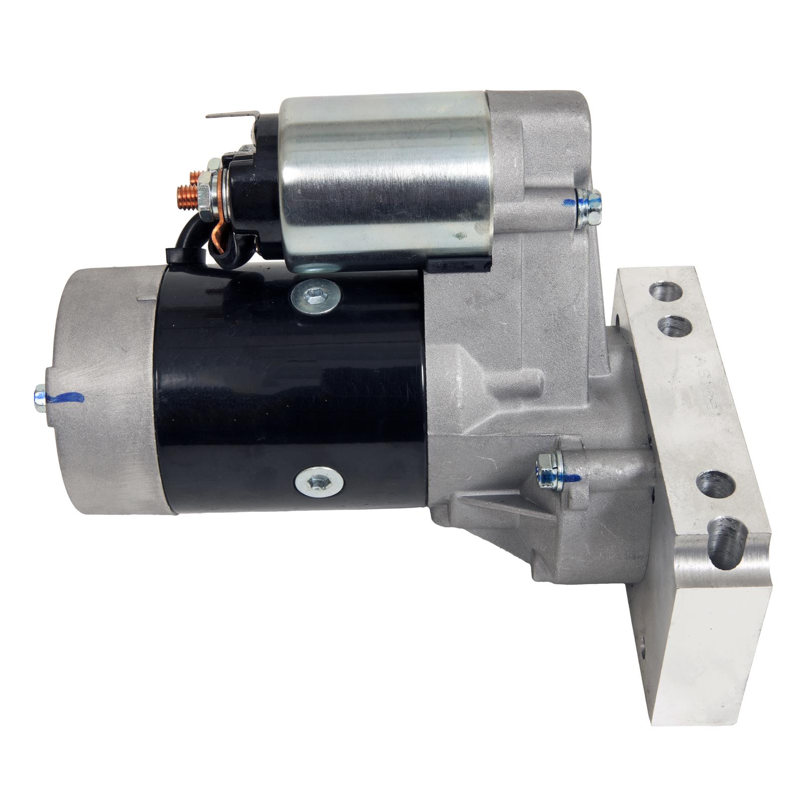

My starter was loud and would grind from time to time. Tried to shim it, and that didn't fix anything.
Gave up and bought a high torque gear reduction mini starter.
It solved all the problems with no shims required.
Always use new starter bolts when putting in a new starter.
I paid $150.48 on Amazon.
