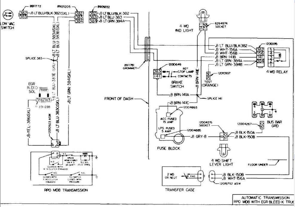

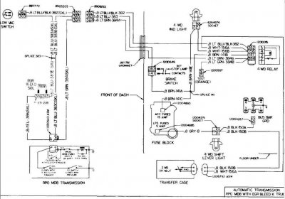

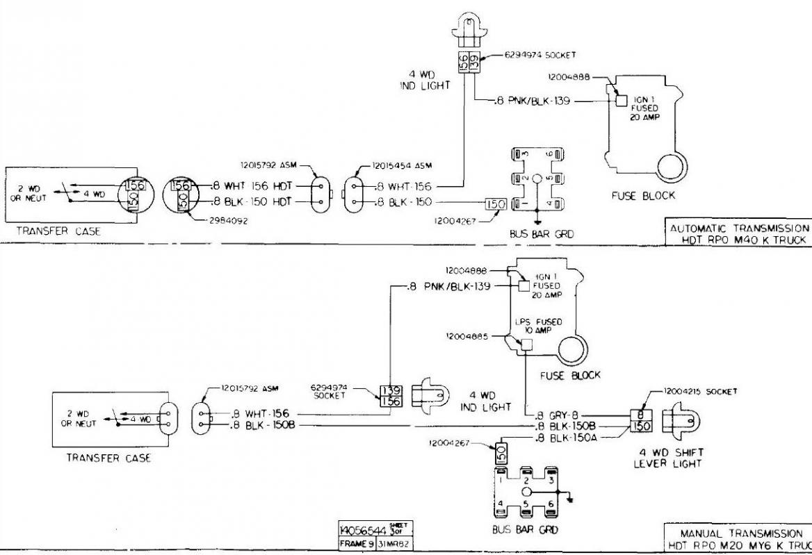

I have a 1981 K30 with a np205 t-case. I have been looking at wiring diagrams and have found nothing for the light switch on the case. Not a big deal if it gets wired. Just have a hot wire for it but no return wire. Just would like to know if anyone has one wired up or know of a wire diagram that shows it?
