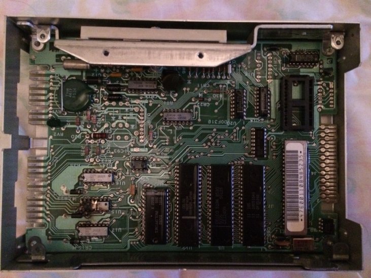

I misunderstood. Cancel the ICM. I thought you said it wouldn't start since you did that with the wire. Did you ever run long enough get your base timing? Well, you replaced the MAP with no results. How about the vacuum line? Mine melted one time for touching the EGR in a not good place, and that was about the worst it ever ran. There could be a wiring issue there so try to trace as much as you can. When Code 34 happens, the computer is supposed to substitute a fixed pressure value and divert the MAP's job to the TPS. You could check that, but I don't think the TPS is the problem. Something really makes me suspect the ECM here, especially if you're still getting the same code with two different sensors. If you got a third one and it did the same thing, you verified as much wiring as possible, and your vacuum was okay, I'd be pretty certain on the ECM. The 7747 ECM is fairly simple. You can take it out, look at it, and see if it's burned anywhere if you want.

This is my old 7169 ECM that I saved from my '86 Caprice. It was running terrible, and I'd troubleshooted through everything but the computer. I pulled it, opened it up, and look what I found on the bottom left hand side.
