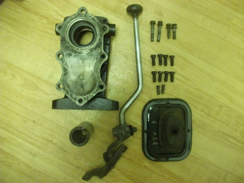

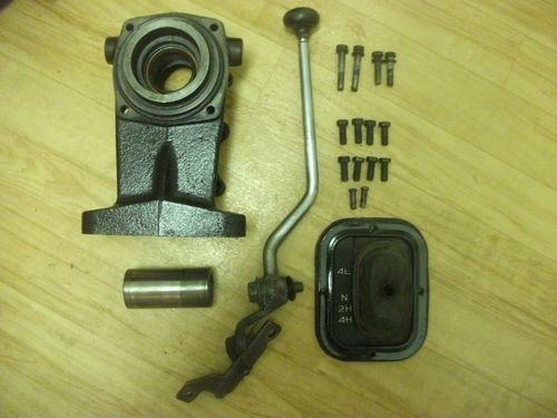

He just needs a 27 spline with coupler adapter for an NP205 I do beleive. Th350 is gay and has 2 male trans output and Tcase male input shafts. So you need a coupler as a ***** to join the 2. You know, one gets her in the booty, the other gets her in the cooter. Racetrack pattern is likely what you need.
OR depending on which output shaft your Th350 has currently, and it's compatible with NP205 which I think it is, them possibly a 10 spline coupler.
Really the NP203 doesn't sound to be your issue. You mentioned peg legger. That has to do you with your axles. Put a locker in the rear and a Limited slip in the front, then you can use LOC on your Tcase, and your rock solid other than the limited about of slip up front, which you'll welcome.
attachment.php
