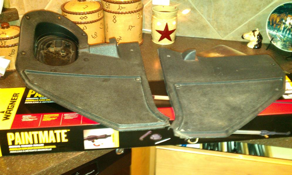

passenger side pull vent. not on driver side, i don't think. vent door and trim piece are the same. just need rod and knob to convert to manual. and the circular shield comes off too.
Really, the trim piece is the same?

if you look at LMC, the trim piece looks the same minus the rounded piece. vent flap is same. if i emailed you pics, could you post them?
24,920
7,065
Absoloutley.
These are mine I put in last week. If you notice the right panel has a chrome plug and shaft tunnel for a pull handle, also the door is attatched to the panel itself.

ya, only vent on passenger side.
