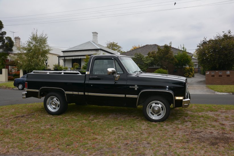

I want to drop my 86 silverado 2 inchs front and rear.I like the way it sits but would just like it a little less 4WD looking.It is running 17 inch wheels.
I bought some 2 inch lowering shackles for the rear and dropped the rear 1 inch just to see what a difference it made was thinking I could just buy some 2 inch lowering springs for the front and drop the rear the other inch available with the shackles.
Will the front springs ruin the ride quality ? Australian roads are potholed crap so ride quality counts here!
Is it worthy going with 2.5 lowering spindles with such a mild drop?

I'd say either springs or shackles will work fine and it's just up to you what you'd prefer. If it was me I'd do the spindles

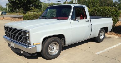

Do either a 2/4 or 4/6 drop, better fit for the 17s and less wheel gap with fenders, better handling and over all better looking!
