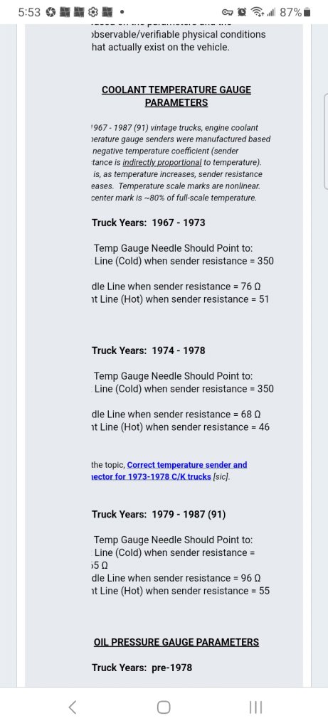

Double check me but I think 74-78 cold reading should be 350 ohms. I'm thinking you have the wrong sender to the best of my knowledge there are 3 and all 3 are different resistance.

6,445
10,970
Resistance
