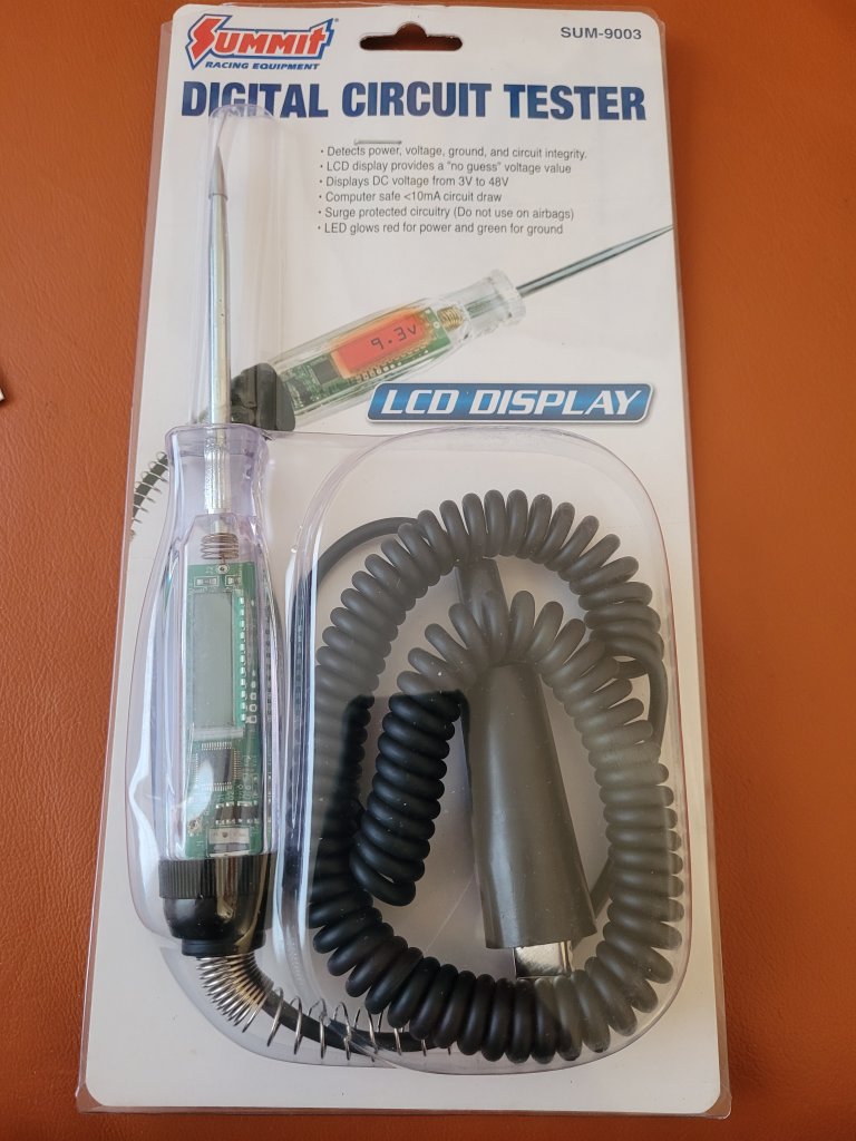

I would start by purchasing a colored wiring diagram and if you don't already have a test light, I would get one. Summit racing has one for $16.00 that lights red for positive voltage and green for negative voltage. It also has a display that shows volts. First thing I would do is check grounds to make sure they are all connected and free of paint and rust. Next I would visually inspect as much of the wiring as you can, looking for electrical that looks like it was done by someone that shouldn't be doing wiring.
