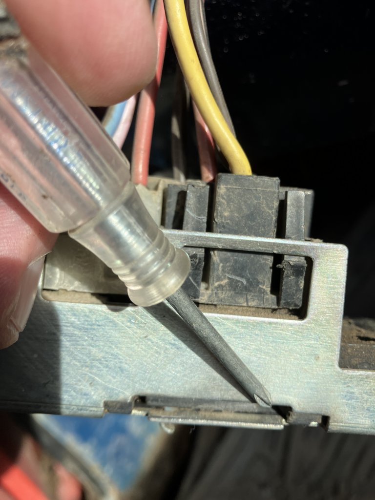

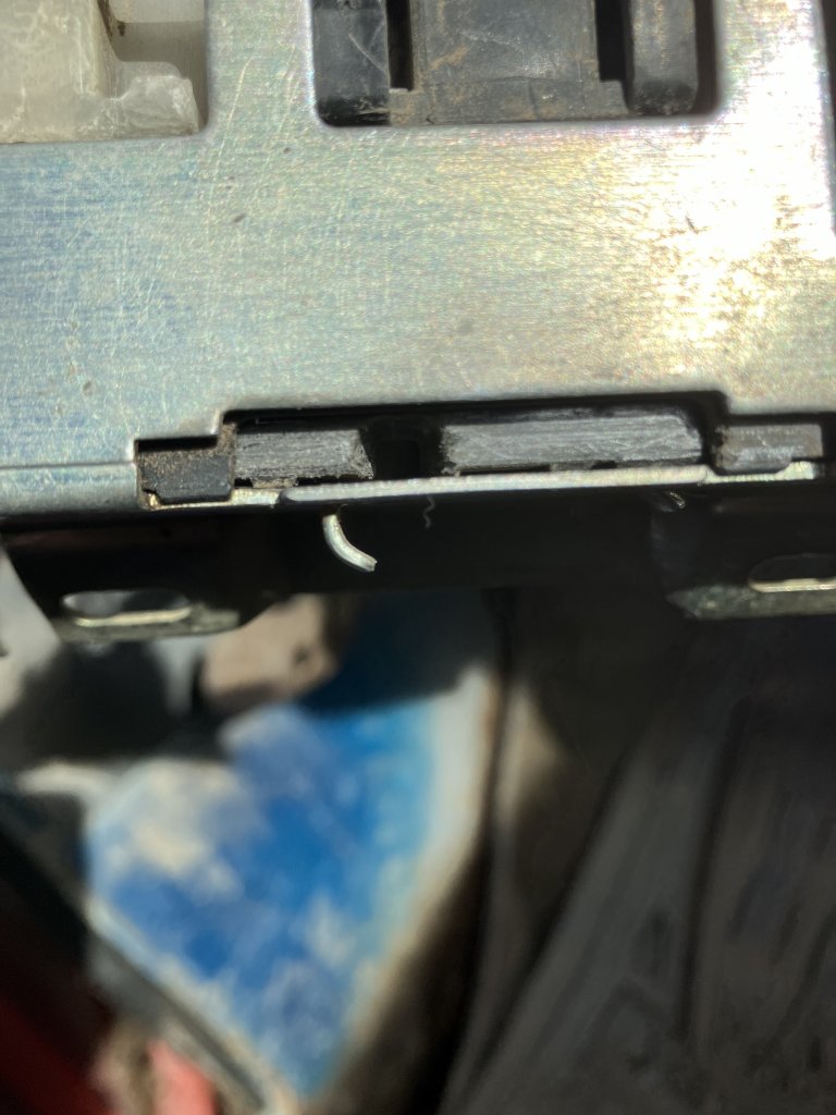

Pics First is off position, second is power on, next position on second pic going left would be start. On my 73 K10. I use that little screwdriver to start this truck, been that way for years, don't drive it on the road much, 100,000 miles of huntin and rocky hills have wore out the ball joints. And Nobody is gonna steal this thing!!
