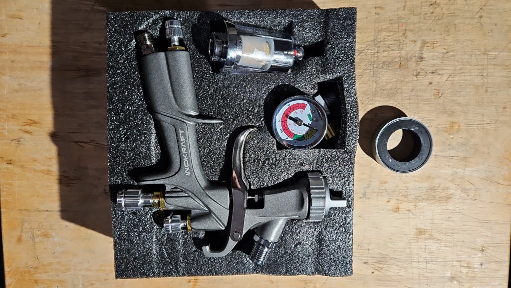

Good evening, (in the voice of Alfred Hitchcock)..lol
Fresh from the postman, my new Inokraft D1.
I've seen some good reviews and figured it a step up from the $30 Hazard Fraught gun.
I'll use that one for primer.
Everything seems well machined and of good fitment. However I have not yet completely torn it down for the initial cleaning.

Did you intentionally buy an LVLP spray gun. You are talking about it being a step up from your harbor freight gun,which I would believe,but check it I'm thinking your HF gun is HVLP. Wondering why you are switching?

Yes, I intentionally went with LPLV and from what I was seeing, that is supposed to be a better set up for metalic flake automotive.
I have no experience with it.
My only recent experience has been shooting the hood on my Taco with the Harbor Freight HVLP gun.
This new gun has 3 tips and needles whis gives way more versitility.
We shall see, come summer.

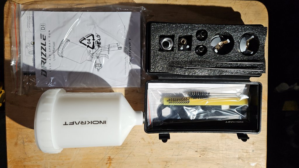

One of my reasons for getting this Inokraft gun was the availability of parts and support.
I completely understand the thoughts of buying a $10 or $15 gun, use it and when it eventually fails, toss it and buy another.
I'm a bit old skool. I like to be able to learn the characteristics of a tool so I can be a better user of it.
When I was in high school, I could of bought a Badger airbrush or a Paashe airbrush. Badgers were less expensive, but they just didn't have a good following among artists. The Paashe also seemed to have more availibility of parts, but it really set me back. I had to mow a few more lawns to get it. I still have it and never regreted it. I shot so much model aircraft metal flake paint that I actually wore out a few needles and cones.

The D1 drizzle is a very good gun. I have it under the name Areopro A610, I think they are made at the same company.
Base coat sprays at around 24 to 26 PSI. Clear coat at 28 to 30 PSI. Light basecoat for the first round and let it flash 10 to 15 mins. 2nd coat medium to heavy depending on temp mostly with 75% overlap. Almost the same with clear. The LVLP guns have a lot less overspray and can be run on a smaller compressor (within reason)
