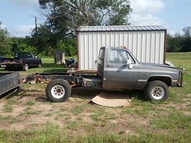

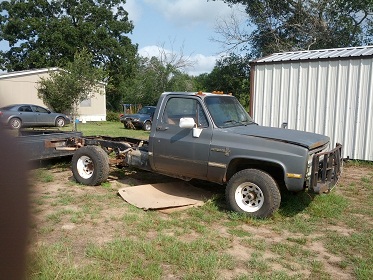

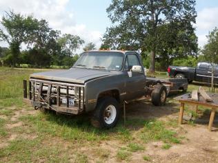

Hello guys, im Trevor from Brenham, TX. This is my awsome new project. Its a 1987 TBI 454 k30 single wheel. My plans for this truck are as follows.
1. Get it running!!! Its been sitting for about a year so its not that bad. That way i can see is the sm465 and np205 are working allright. Something is wrong with the fuel injection system and i cant figure out what it is so i think i will slap a carb ond a distributor on it so i can put around in the pasture.
2. Lift it to the moon!!!!!! Just kidding, though i do plan on around 10 inches of suspinsion lift.
3. Rebuild those awsome axles and install ARB lockers. Maybe remove the inner nuckles on the front dana 60 so i can adjust the pinion angle and keep the castor good too, though im not sure if thats necessary for 10-12" of lift. guess ill ask you guys about that when the time comes.
4. Slap some 40"+ meats on it. Not sure what brand/type. I need something that will work good in deep mud and is still okay on the street. I have plenty of time to figure it out.
Between all that probably rebuild that motor with oval port heads and a better fuel system. Restore the whole truck inside and out because its pretty rough.
I plan on starting a thread once i get something constructive going. Ive just been piddling around lately with it because its been so HOT down here in TX.
Im glad to be part of this awsome comunnity
later guys
