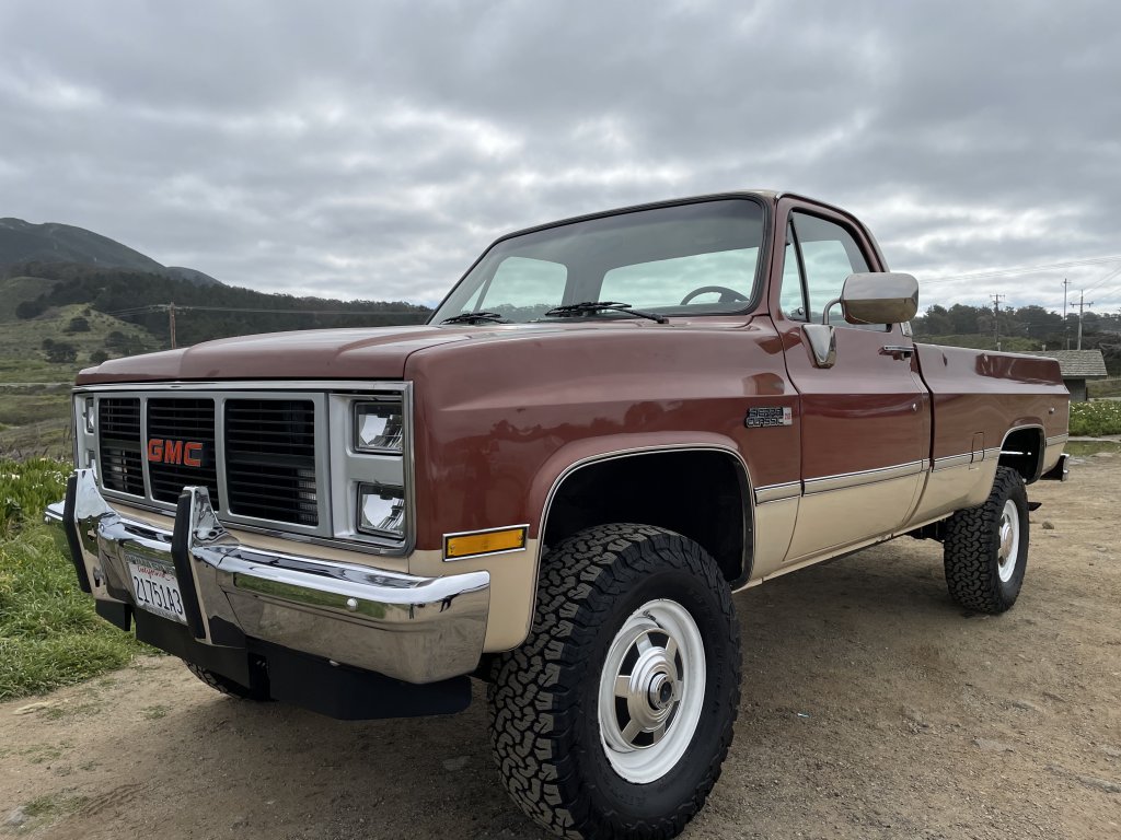

Greetings.
I have an 87 V2500 GMC 4X4 3/4 ton with a TBI 350 / TH400 / NP 208
Truck is original one owner before me. speedo shows 93k. Motor runs great. I tested sending unit and it was bad. it showed low oil pressure so I changed it out with the correct delco unit. Now it shows 60psi at start up, when driving it shows about 50 psi on freeway. when its up to temp at idle it shows 45psi.
What oil should I use? I have Lukas Hot rod oil in it now that is 4qts of 10/40 and 1 qt of lukas oil stabilizer. truck is not driven much. I would like to keep it as original ass possible for as long as I can.
Should I be running Lukas 5-30 oil to lower the oil pressure? the oil pressure seems high to me? any help would be great! thanks!

Nah. You're good. When it gets colder, you being in Nor-Cal, going to a 5-30 may be better. As is it sounds like you have real good OP, nothing to be concerned with.

#1, As recommended already, it's not terribly important what weight oil you use. I'd run 10W30 with that oil pressure though. It's good pressure and providing plenty of lube and the lighter weight will help a little with the fuel mileage.
#2, Love that truck color scheme. Funny enough, I was working as a tech at a GMC dealer in those days. I ALMOST bought the same truck. We had one on the lot and I ended up buying a Monte Carlo SS instead.
