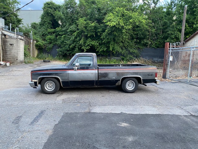

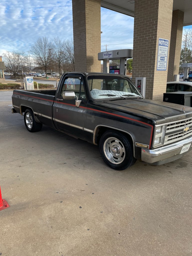

i just realized i neglected to update my sob story here! i finally figured out what the idle problem was, the distributor!! i put a new one and the truck idles perfectly. I had the front and rear suspension rebuilt (too heavy a job for this old guy :)) using dropped spindles in front, and the higher spring support and shackles in the back, and just had the rear axle rebuilt with 3.42 gears and positraction. Next in line is to raise the carrier bearing for the two-piece driveshaft, as it is now working at an ugly angle. After that i will check the angle at the last u-joint, as it seems to me the pinion angle changed a little with raising the supports for the springs, maybe have to put some wedges there to correct it.

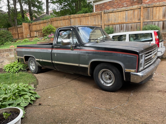

I realize I never properly closed this thread. The cause of all my suffering here was the distributor. Put a new one in, timed it, and the truck has been running smooth as silk. I need now to update my photo!
