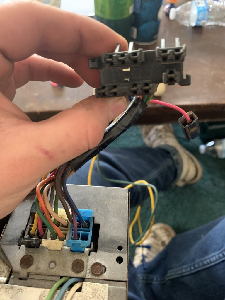

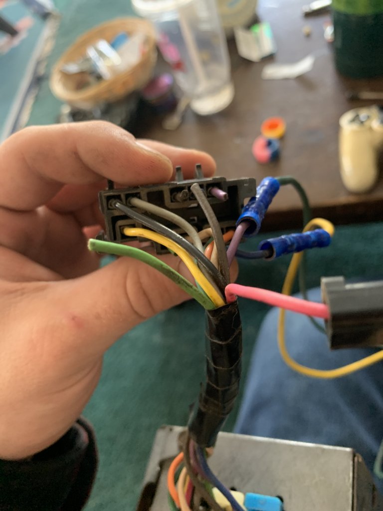

Ive recently took the radio out to see if i could fix it after someone had cut and spliced a bunch of wires too it. I was wondering if someone could help me identify which wire goes to what on the pigtail or atleast point me to a diagram of the connector

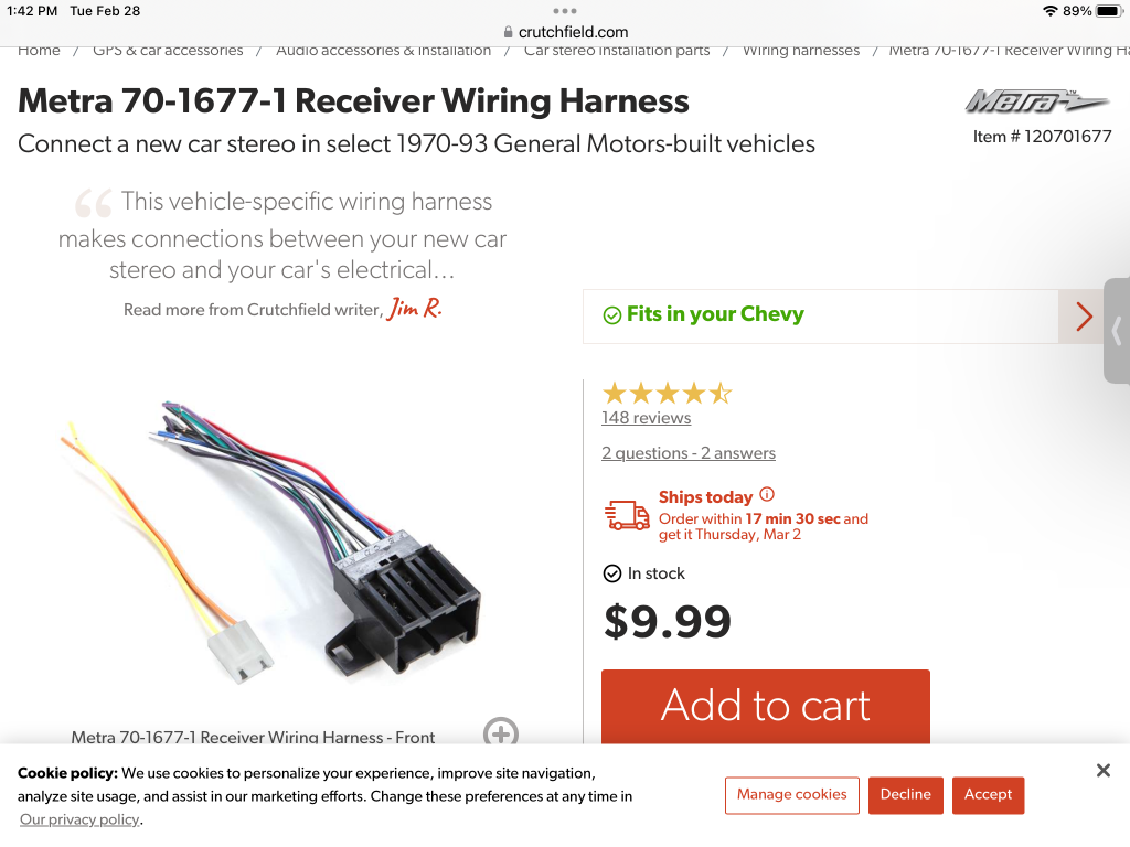

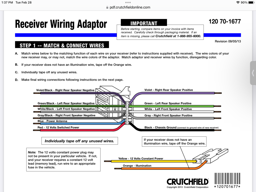

Crutchfield wiring adapter

Crutchfield wiring adapter, great way to go!
