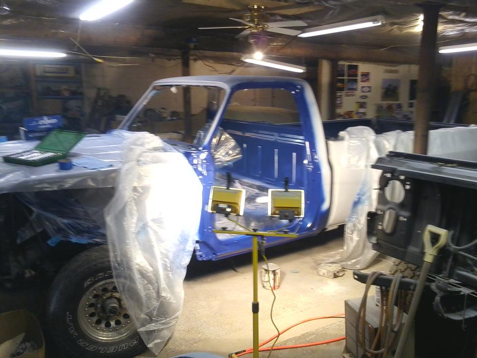

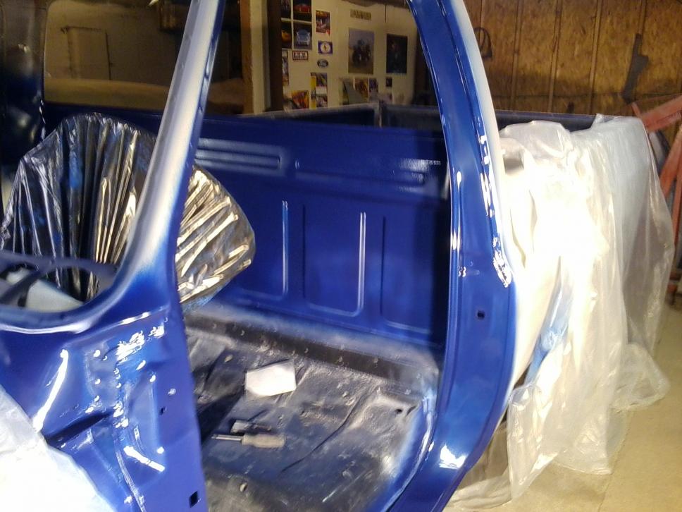

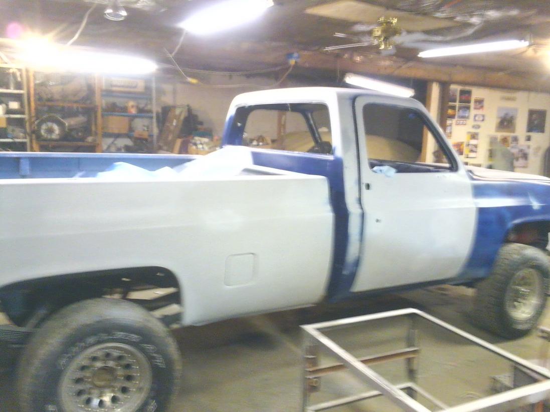

Painted the cab forward including the door jambs on mine in my garage. Used single stage Kirker paint.
What I started with.
During
Finished for now.

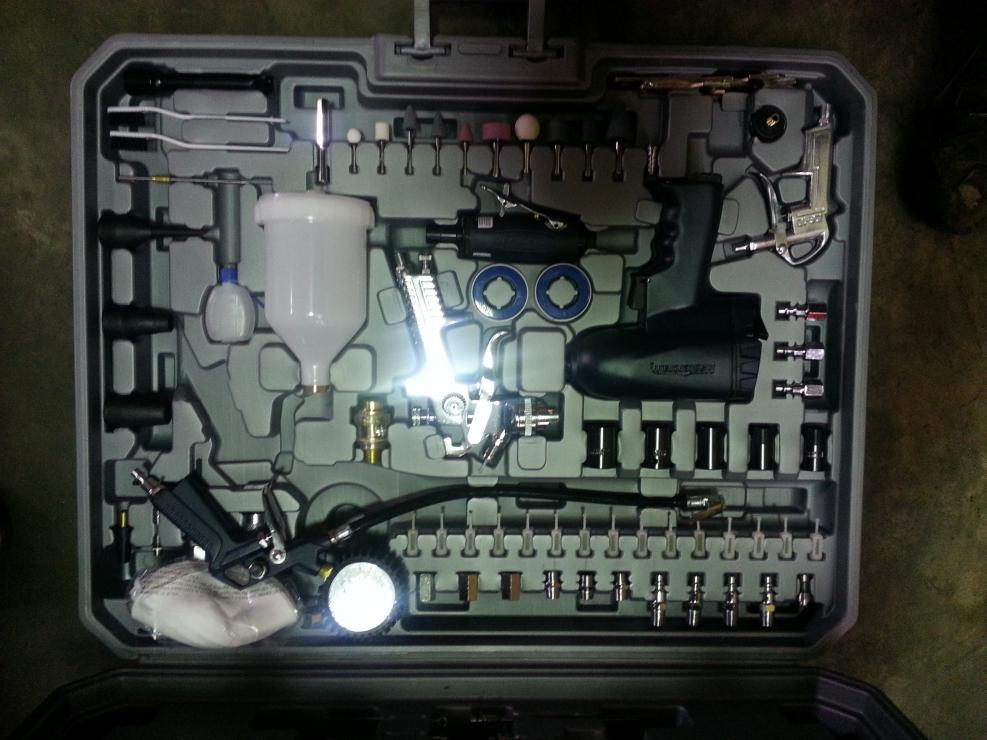

Right now I have this set 359 $ marked down to 89 and I got it for 45 so a great find I think!

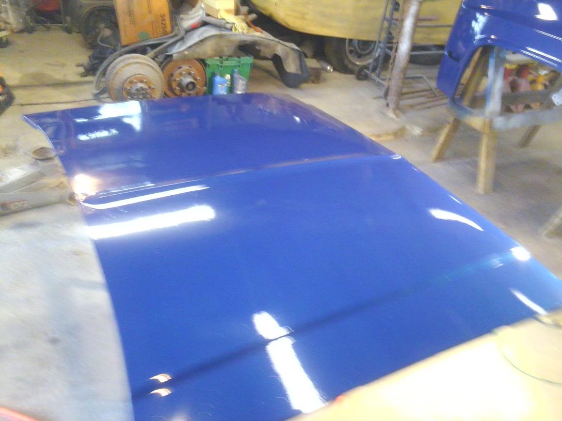

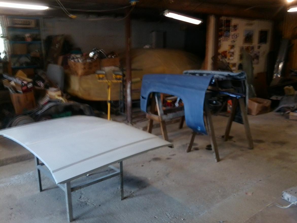

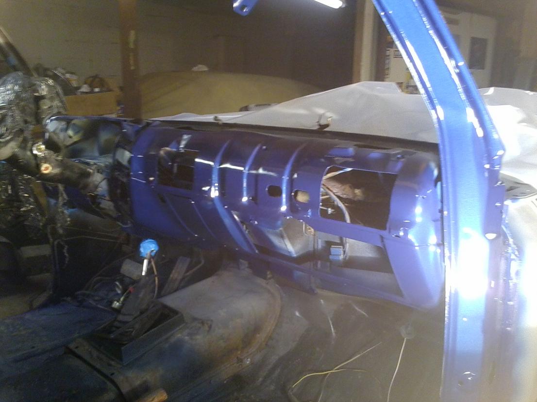

here is my k20 i painted last spring, but i am painting it again when it gets warmr because i am not happy with it. i want it nicer :)

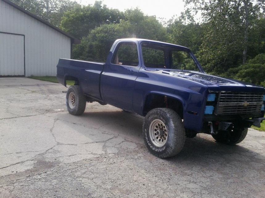

just a few more pics. It looks good in the picture but it isnt what i want
