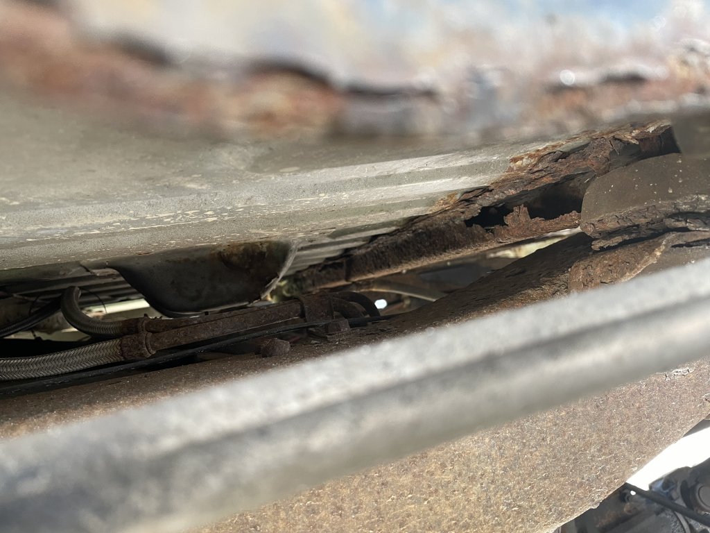

I have a 1990 2wd burb and one of the rails in the rear with the body mount it’s roached. What is or what have guys done to repair this. Aside from taking the whole body off the frame.
Thanks in advance!

I imagine they're similar to the pickup box supports. Closest thing you'll get most likely.

The only proper way to fix that is to pull the body off, drill out what spot welds you can/cut the rest off, encapsulate the rust and weld back in a new cross sill. You'll either need to find a parts truck to pull one off of or modify a truck bed cross sill to work.
Looking at all the flaking, you're probably going to need that body mount as well and possibly some frame work. Personally, I'd be looking to buy a cleaner 'burb and swap any of your good stuff on it
