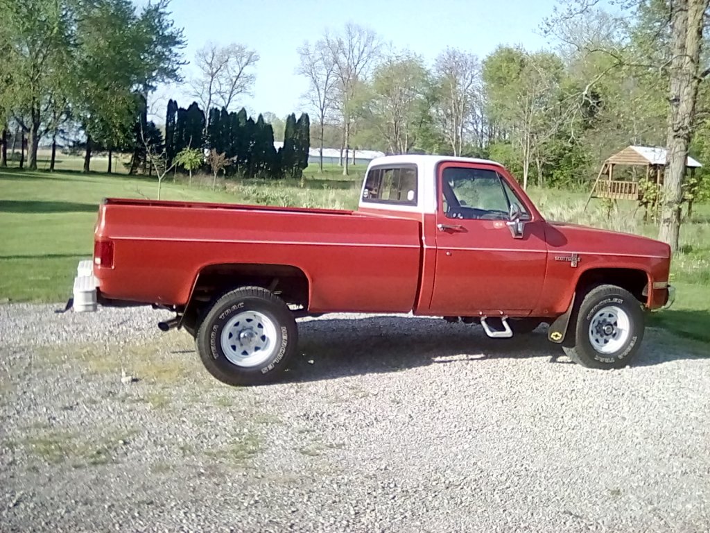

A set of steps is about the easiest way to go. I added these for those folks that seemed to struggle climbing into The '87.

That's one gorgeous truck, wouldn't those steps worsen the rust in that area, though?
Thank you! No Sir, the bolts should not have any effect on rust IF the rust is just light surface rust and IF you take decent care of the metal. What you see on my truck is really light and is due to the original owner driving on gravel roads. I hope to be able to paint The '87 in the next couple of years and all that will go away.
Those steps are relatively cheap, they are an easy installation and they work...okay. You have to install them a little far forward because of the gas tanks. That was as far back as I could fit them.
They are fairly useful even if they are a little farther forward than I wanted them. They are much better than nothing.
