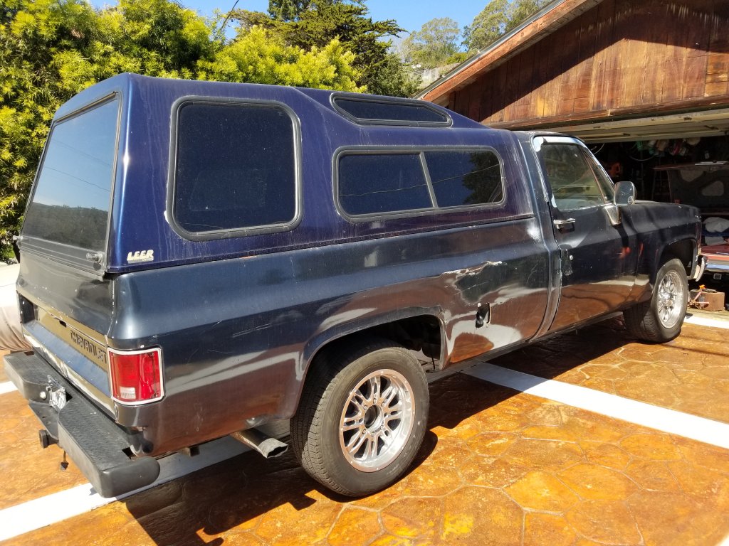

Just bought an 85 C20 Fleetside Longbed with 8 lug wheels all around what do I call this configuration? I plan to drop the truck with flip kit in rear, but front is another matter. Are the spindles the same throughout the C Class? Rather is the 8 lug (I guess this is classed as a 1 ton rated) lug configuration strickley a different rotor? or is the whole spindle assy different? I live in Northern California Is there any square body salvage yards in this area? Any help will be most appreciated.

8 lug on 3/4 ton is normal. Can't say for sure about the spindle difference, I believe there's ways to go about a 5 lug/8 lug swap, although I might be getting mixed up. Good luck with it either way!
