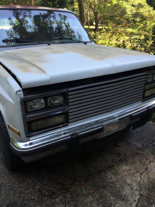

I have a few threads floating around, figured I would just consolidate and keep it all here. I recently bought a 1991 v1500 suburban with 200k miles. Planning on building it into a beach vehicle/camping expedition type vehicle.
I figure I would post pics in here as I go along and and make this my build thread. I am by no means a master mechanic and will likely be soliciting advice periodically.

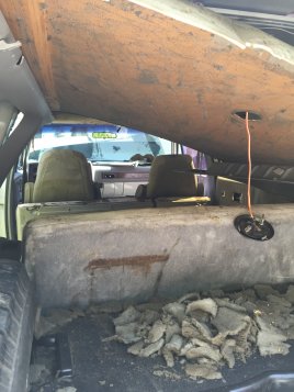

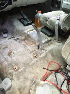

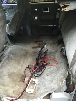

So far I have gutted the rear carpet as it was horrible and covered with mouse ****. I still think he is living in there but I'll get him. any ways I am going to remove the rest soon and bed line the cab and then carpet over for the front two rows.

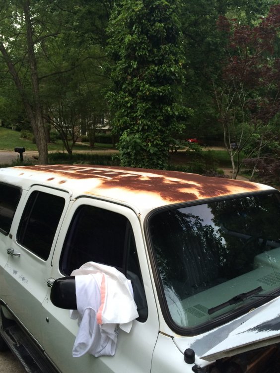

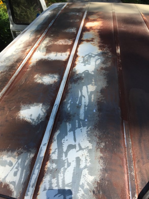

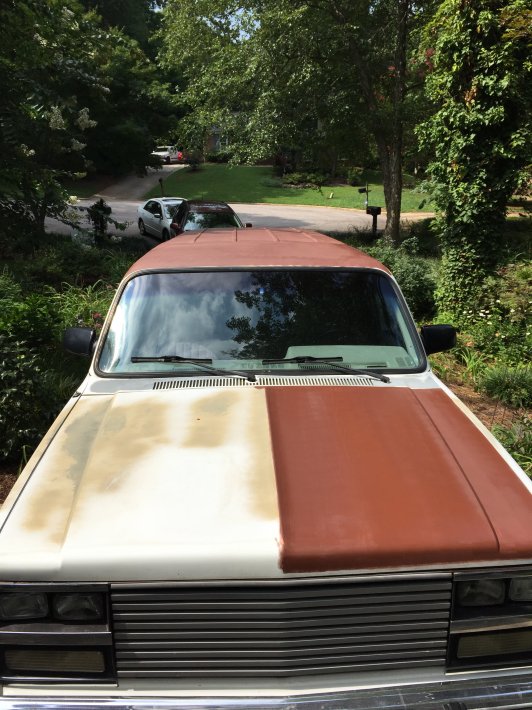

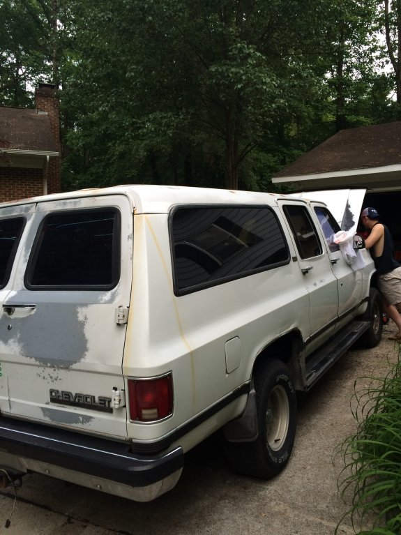

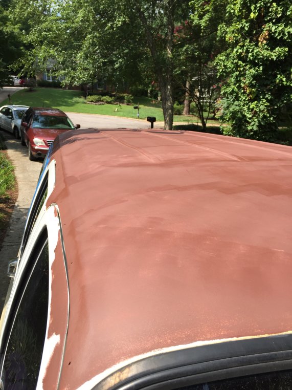

I have surface rust on the roof I will repair and lower barn door rust I am going to probably end up cutting off. then I will plastidip it.

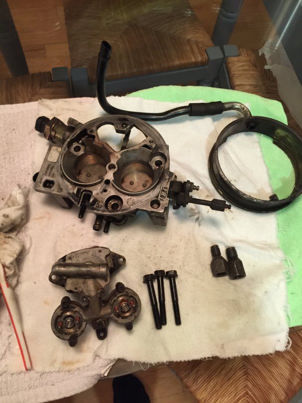

last night it passed inspection amazingly so I took it back and removed the TBI to clean it and maybe do some mods, ill have to order a rebuild kit for it, all the gaskets literally were gone or crumbled.
Once I figure out how to post pictures I will.
Plans for the future are 4 inch lift from ORD most likely with 35s or a 3 inch lift with 33s. roof rack, gears (haven't decided what yet) and I will have to learn how. rear locker (maybe front) I don't plan on changing axles as I wont be rock crawling just some fording and exploring and beach camping. Likely custom front bumper for surf fishing and rear for spare and fuel. New exhaust to get rid of the restrictive Y pipe and maybe long tube heads.
Other than that I have gotten further on ideas yet.

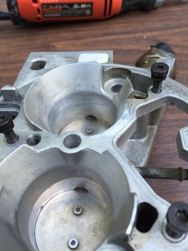

I was able to clean up the throttle body and it will go back on this week after I clean the engine bay up some and remove some ratty wiring the previous owner had put in. Anyone know if vacuum tube can be replaced easily or is there a protocol to removing them?

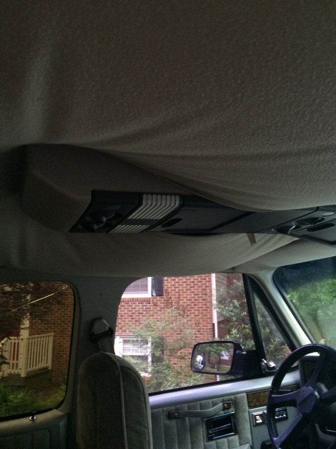

Alright, throttle body has been completed, new radiator and thermostat along with hoses. I have removed the rear interior carpet and headliner as well.
I am going to continue deep clean this week so far no more rust has been found other than the surface on the roof and some under the barn door. I did find an insane amount of mouse left over on top of the headliner and under the carpet but after traps inside for 2 weeks I think they are gone.

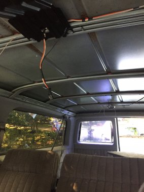

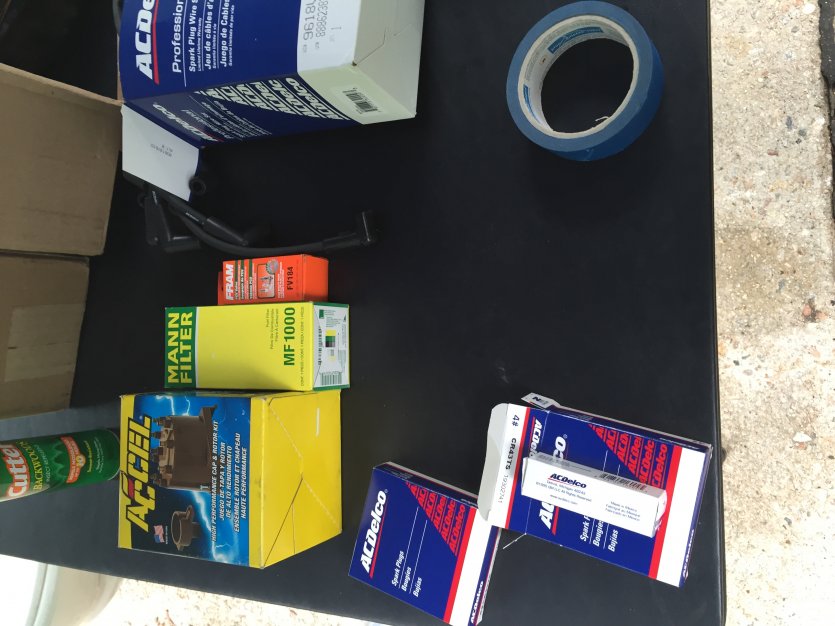

more disassembly pics, parts for tune up on order also, I bought some Frost king HVAC insulation too to put down after I fix a bit of floor pan rust. Called ORD for a price quote on 4 inch lift and greasable bushing kit and steering brace, gonna cost me about $1000.00 so I guess ill get everything else up to shape first. Going through all the RPO codes too.

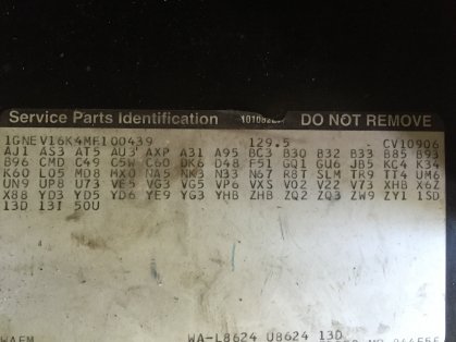

maybe im wrong, but going through RPOs I saw this is a 3.42 rear??? if so im not happy, I thought it was definitely a 3.73. is fo I guess I might as well go FF 14 bolt with 4.10 now and D60 front. I was hoping to just get a SF 3.73 14 bolt....damn....probably best to get these before the lift too

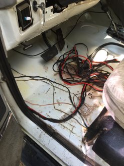

Update: Having a horrible time removing all the excess wiring in this thing. I think I finally disconnected the horrible aftermarket alarm system, cut off the speaker as it kept going off and cleaned the engine bay connections out however trying to unhook, all the connections into the ignition controls is proving a PITA. I really am trying to avoid doing major harm to any wiring so at this point I may just shove the rets under the dash for the time being.
The amplifier cables that were run were not as bad but with all the other wires along with them it is fun figuring out which firewall locations the PO ran them through. At least it is helping me scout some good locations for my CB and possible HAM. I will try and post more pics up soon. Any one have any advice on the previous questions? I am also trying to figure out if regular corrugated wire wrap will be good for inside the engine bay or if I will need specific heat resistant covering, all the old stuff is falling apart

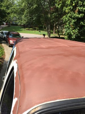

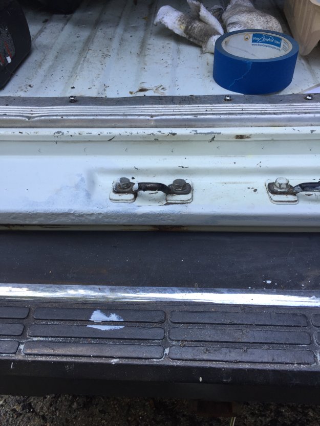

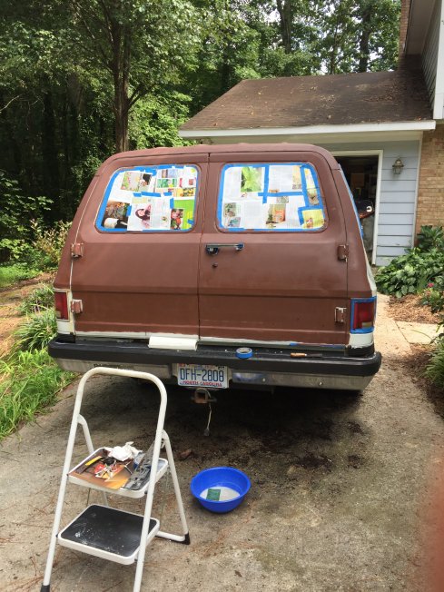

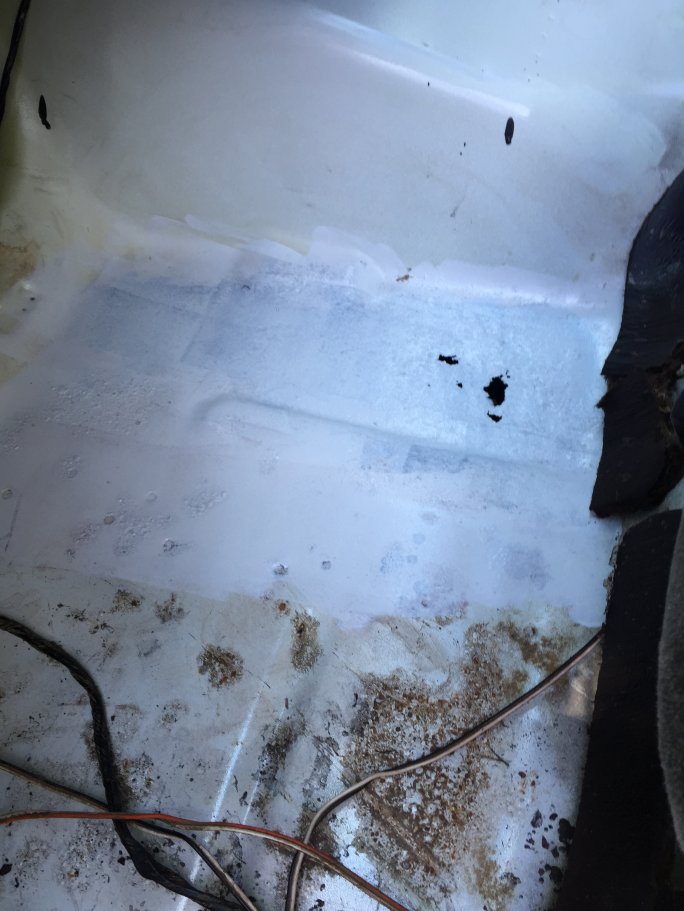

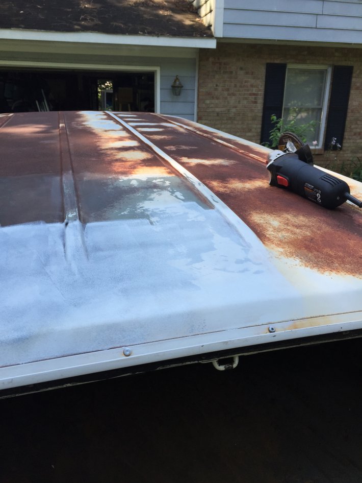

got some work done on sanding and priming this weekend,not as much as I would have like but oh well, used rust converter primer after some grinding, as Im not going for show quality you will see its just being rolled on. hopefully I can get it all taped and painted in the next week or so.
heres some pics
