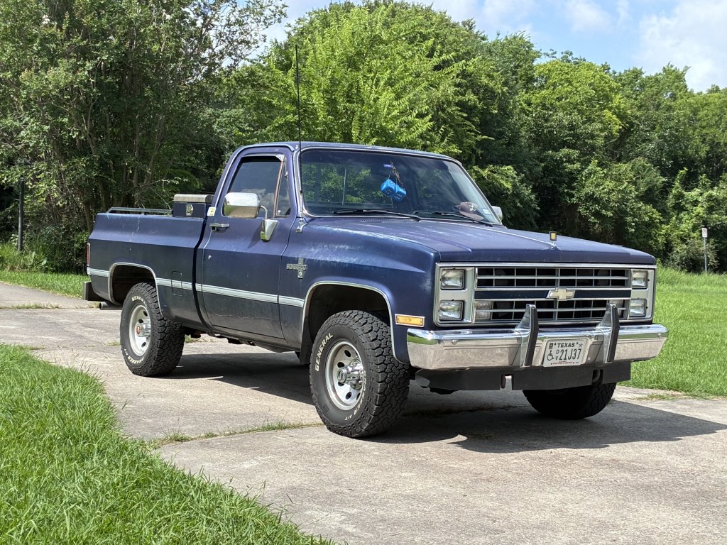

So my solution to this problem was to use the windshield antenna for am/fm and add a stud/quick disconnect/spring/3’ Firefly antenna to the GM accessory fender antenna mount. Works great, no problem between CB and my AM/FM radio. I think I was just overthinking things. Anyway, all’s well that ends well.
