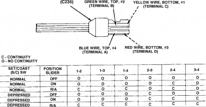

All the cruise control switch components are contained within that big fat bulb on the end of the stalk. The leads (4) from the control switch to the main harness are all contained in that cable with the weird looking connection on the end - see the image below. There is no need to change the current MFS.
To re-activate the CC: just yank the non-cruise stalk out of the MFS, fish that coax type cable down between the column and the outer casing and pop the cruise equipped stalk into the existing socket. No wiring associated with the cruise control passes through the MFS - it just passes by it.
After you have fished the wire from the CC switch down and out of the bottom of the steering column... just find the female side of the connection and plug it in.
If everything else is in order, you should be good to go.
