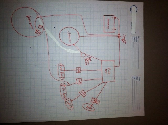

ok i made this up and im not sure if its right can someone look and see if this will work?

Lights and radio? I thought you said this was a mud truck? You're adding a lot of different things there, and one problem I see you're going to run into, with the alternator, it will backfeed, and the truck will not turn off when you flip the ignition switch.
What circuits ate you wanting to run? I see ignition, starter, radio?, lighting (consisting of what?) Fuel pump, and I can't read the others.

On our mud race trucks we don't run alternators.
http://www.ebay.com/itm/6-Fuse-Pane...Parts_Accessories&hash=item4602d95d41&vxp=mtr
You run a single wire to that fuse panel. And it gives you fuses to your accessories you want. I'd put one of those to the ignition. And i would remove all stock fusible links.
This is what i will be running in my mud truck. But i will be using the stock wiring for the head and tail lights. And no stock wiring on the engine side.

Well i got to thinking and decided to put a set of kc lights for headlights and i figured a radio would be easy to wire up so i could jam while im destroying a mud hole haha

How should i wire the alternator and as far as the lights and radio i really dont think thats really that much extra its only two more things plus i might add cooling fans later on down the rd when i move my radiator and trans cooler to the bed.

So this isn't a comp mud truck... Just use the stock wiring.

naw ill figure it out i dont want the computer or any of that other crap in there i took the fuse box loose from the firewall and it looked like it had been melted at one time so im just going to redo it all the way i want it but thanks for the advice on the alternator.
