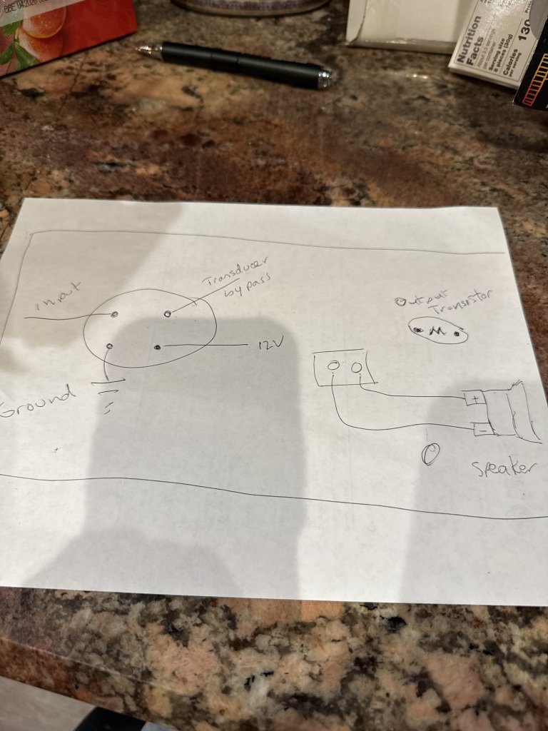

Turbo looking at your reverb from the 4 pin connector side it connects like this:
If you want to bypass the transducer (reverb spring) jumper across the top two points. I’d blow out all the dust inside and look for burnt resistors before powering it up. Also check power to ground with an ohm meter and make sure it’s not shorted prior to firing it up. You don’t need the fancy control module. You could just use a DPDT switch to switch the reverb between reverb and radio. Let me know if you want me to check it out. I’d be glad to.

So are you talking about a switch like this?
Also assuming these old reverb units took speaker level input, wouldn't you also need a fader control for front to rear output?
Next question, what is the transformer doing in the Motorola dash control? The picture on the unit shows which wire to cut open for different speaker's OHM level used with the original mono radio.
Does it look like the reverb has two separate amplifiers?

You can use the volume control on the radio to vary the sound. Typically reverb goes to the rear speaker. The switch just routes the output of the radio through the reverb and over to the rear speaker. The factory switch is just a fancy spdt that looks amazing in the dash. On Delco's they don't use a fader although one certainly could be integrated. I wold say that the transformer is for coupling a signal from the radio to the reverb. I t might be cleaner that way not sure. Delco just sends it straight through from the radio to the reverb with a switch. It's possible that this reverb was meant to be used with a particular radio and the signal needed to be stepped up by a transformer for the reverb to work at its best. Great forum. Thanks for bumping up my count. Im a retired Electrical Engineer and I enjoy tinkering on old electronics to keep my skills sharp. Nothing is cooler than making old stuff work again.

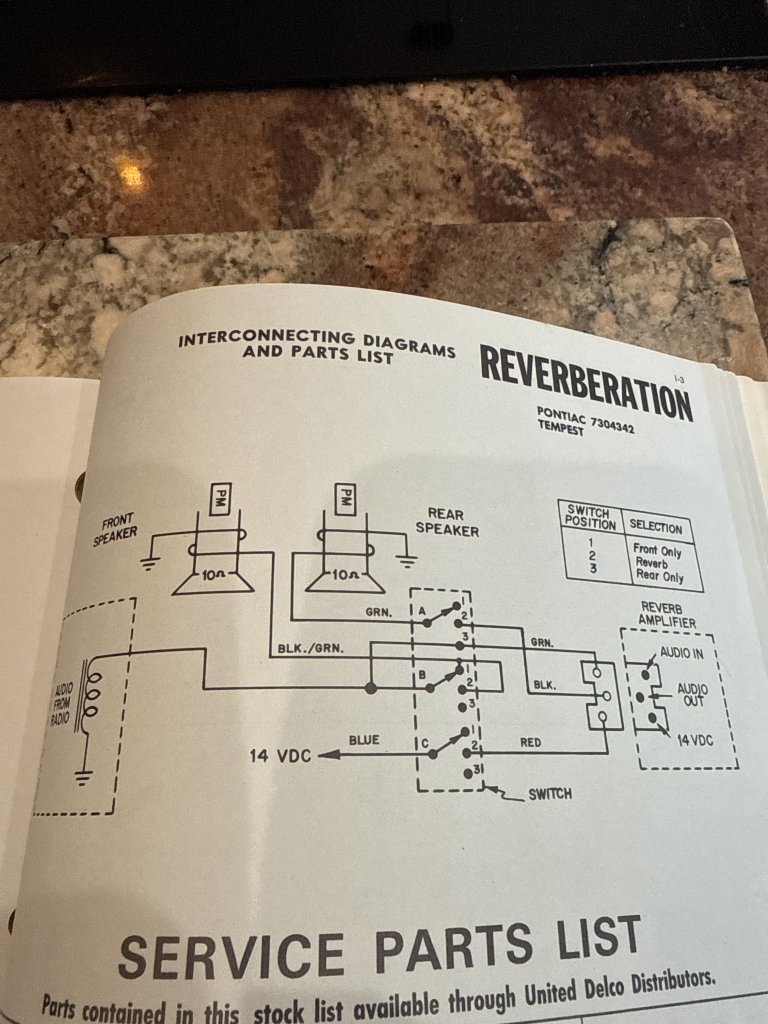

Typical wiring of a delco reverb to speakers through a dash switch. Motorola reverb is almost identical circuit wise so it would work in this configuration. Actually the switch is a 1x3 not a 1x2
