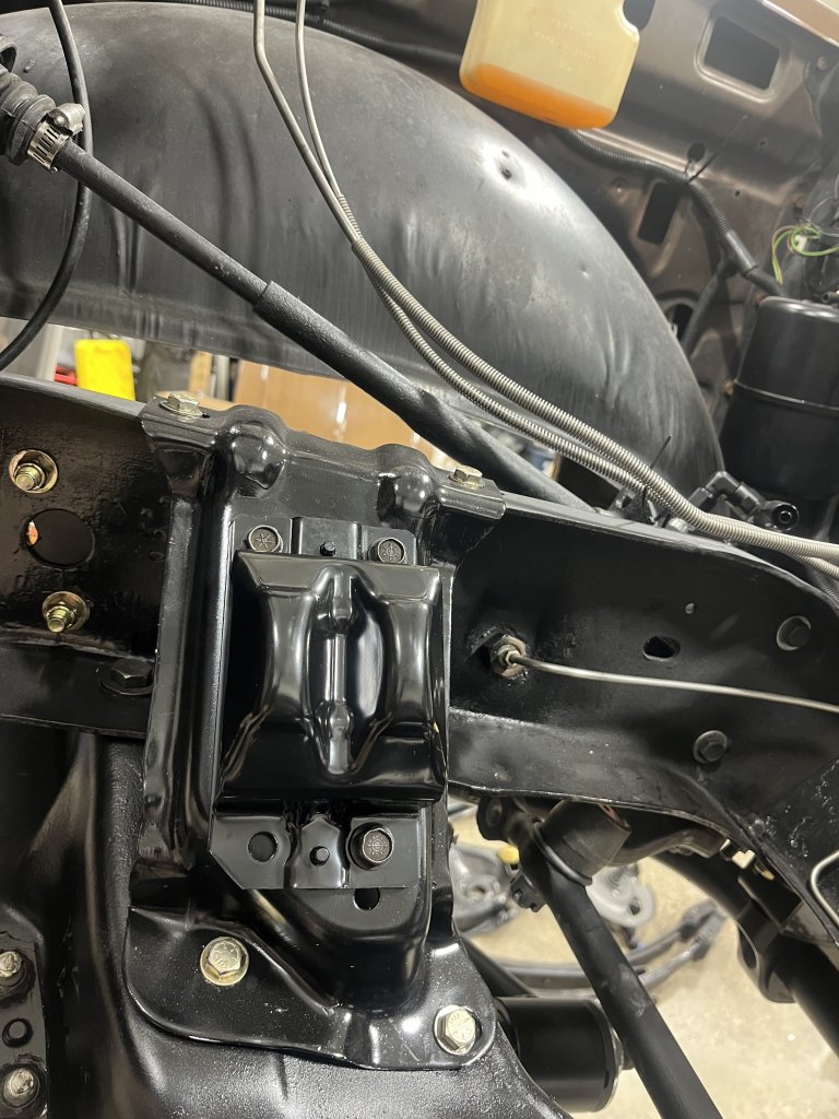

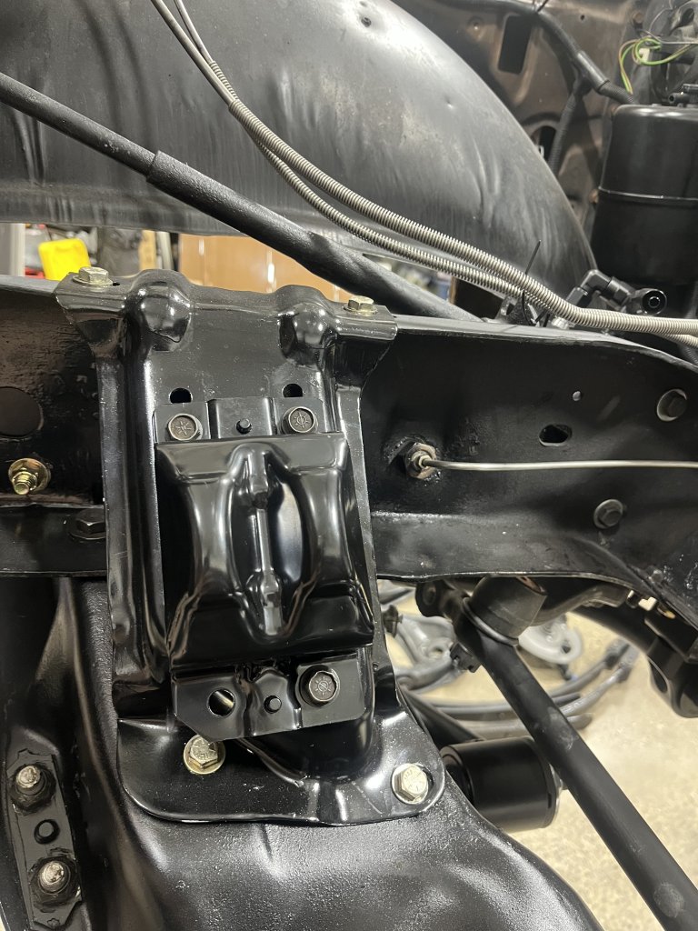

Hello, doing a sb to bb swap on a 78 Chevy c10 and I see that there’s 2 sets of holes that the motor mounts can mount to. Ones about an inch or so lower than the other. My question is if the lower holes are used for big blocks since they sit higher and the other is sb? Or is it the same for both? Pictures might help see what I’m talking about. Thanks for the help! Also, originally this was a I6 truck if that helps.

Big block, cant tell exactly but it appears to be the upper holes
6,437
10,964
Did you ever fix your brake problem? Set your big block in,just like the small block came out,unless you are getting big block mounts and perches. But a big block will sit in just fine mounted up just like it was a small block.

In
interesting, Lower holes must be for I6 motors. Thank you!
