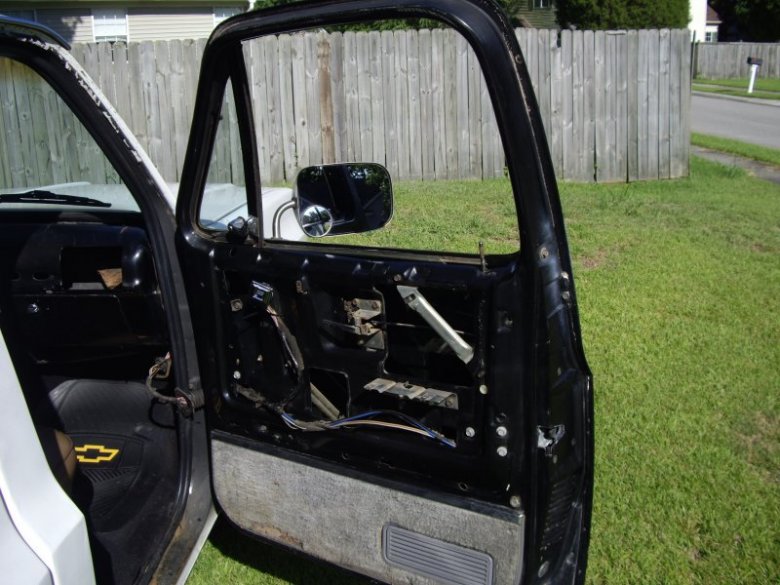

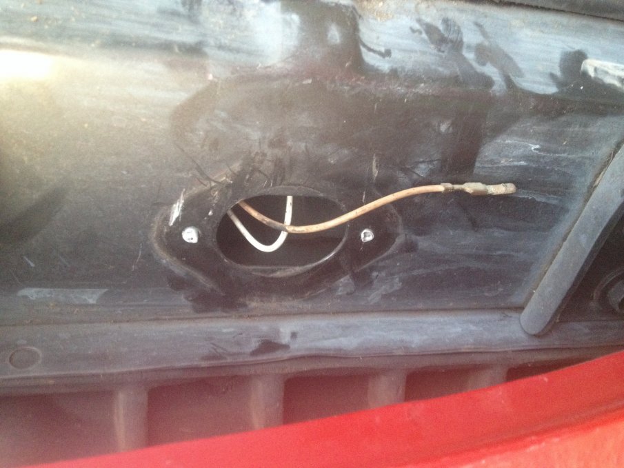

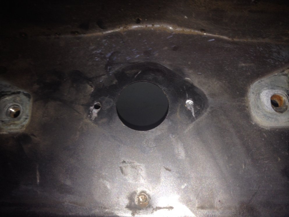

I am working on putting power door locks and windows into my non power truck. I got both doors working and only have the holes to drill in the doors and cab. On the donor vehicle it looks on the cab that the hole is oval instead of round. Is this necessary? I was planning on buying a hole saw but was curious if it would hurt to just drill a round hole instead of oval. It looks like the door and cab are both marked where to drill so location shouldn't be hard. I'll post some pics of the swap when I get the holes drilled and wiring hidden back under dash. Here is a couple of pics of the holes, the oval is on the cab and the round is the door. Thanks for any help

And the oval, I should've mentioned, these holes are where the wiring passes through the door and into the cab. Covered by a rubber flexible boot.

it is a pain to get the connectors and rubber boot through the oval hole in the body

The PO of my 74 attempted to do this swap. He used doors off an 83. If your doors are good and you have a way of cutting the hole in the cab for the wires without removing the door then use your existing doors. I looked at drilling the hole from the inside but decided against it because to get it in the correction position on the outside I would end up behind the emergency brake assembly. Plus the doors needed to come off for paint.
Around here you can get a complete door cheaper than buying the innards. Also get the P/W wiring harness and PL relay from under the dash.
PO of mine did not cut the holes in the cab, he just let them route thru the door opening. He ran the wires from the pass side to driver side and one from the fuse box. To work the windows you had to supply voltage from the fuse box (constant hot no fuse) to the correct wire then get someone to work the switch on the door. Power locks were non op.

I don't know if this will work on earlier model years. But, if you look closely, there should be a series of dimples on the door jamb:
The top and bottom ones line up with the mounting holes in the rubber conduit flanges. They can be drilled - without dropping the door - to accept either a pop rivet or a screw.
Also, the easiest way to make the hole for the wiring harness is with a step drill. The thickness of the harness requires a big one. I picked up a Klein #9 on ebay a couple of years ago (for $30! - they generally retail for over $150):
But Harbor Freight sells a 2 piece set that includes a bit that goes up to 1 3/8":
This set goes for only $18.98 and it should last for a while.
Using a step drill, you can also make the holes for the harness - without dropping the doors.
Unfortunately, if the doors need to be drilled, they have to come off anyway.
